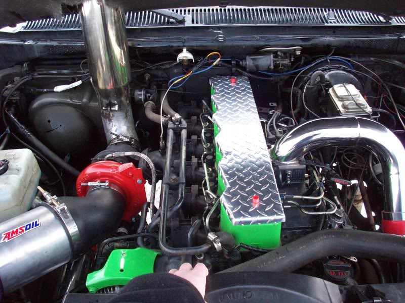

here is a pic when i first put the turbo & hood stack on with the hood off
Its just a piece of metal bent into an L-shape with a hole in the top part and a hole on the bottom part. I just bolted it where the actuator used to be. I then got my J-hook (or turnbuckle if i want it to stay shut) and hooked it to the wastegate, then then hooked the other side into the other hole in the bracket in the bottom and tightened it down. It was an ugly rusty piece, but it works good, I have since painted it to match my turbo.
I know these aren't the best pictures, but i wont be home til tomorrow. Hopefully this gives you an idea on how i did it, but if you need more pictures and how it looks underneath, i'll try and get some tomorrow.
And when i installed my hy35 before this turbo, it was leakin oil out of the oil drain fitting too, so i doubled up the gasket cuz it was barely reaching and put some gasket sealer on it and it sealed right up so you may wanna try that and see if it helps.
