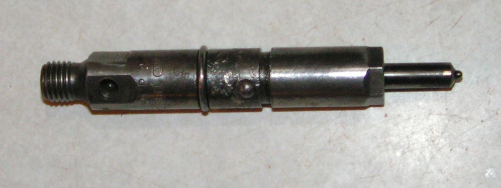

I bought a set of 7x10 sac injectors from them on June 21, 2012. Paid $400 + $150 core charge. They didn't come very soon. There were many phone calls with the response from Jamie, "I'm having trouble finding cores." I finally got a set of injectors 2 1/2 months later. (Sept 10, I think)
The core bodies were pitted, and 2 of them leaked soon after install. I sent them back and they put the tips on some of the cores I had returned.
They always returned phone calls, and they honored their warranty, but I don't think I'll be going back.
