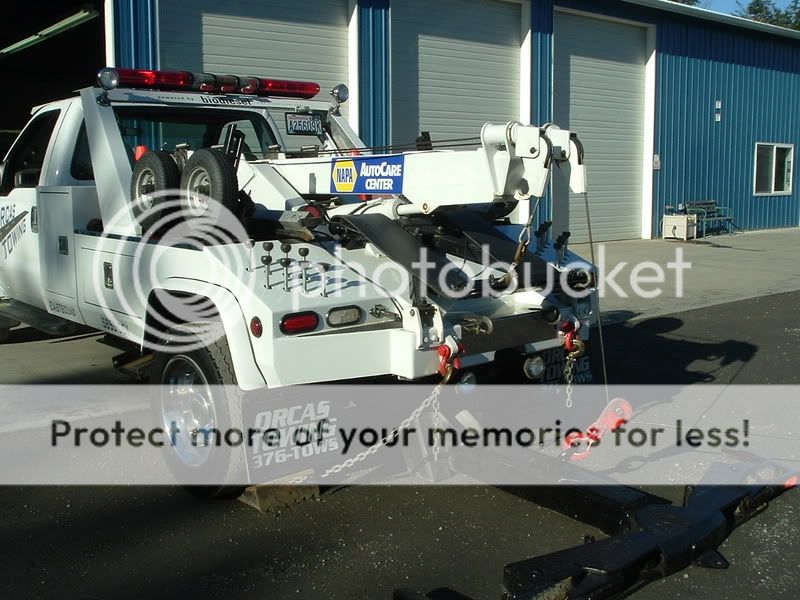

Anchoring the front of a truck to something and winching from the other end is a good way to tear a truck apart. I've had a few hard core 4X4 people's trucks in my shop that have done the worst damage I've ever seen using that technique. The worst was a frame torn in half.
What I recommend is scotch blocks. They're like big chock blocks with chains attached that y ou anchor to the rear of the truck doing the winching. See the pics below.

Thiw is what I'm talking about. Do you have any idea the name for them or scotch blocks it? I will search the net a little but if you know a starting place to look let me know. I was in the army and the 6X6 wreckers used a curved plate that went ino the ground. Was thinking something like that or some kind of spikes. Using a 17k winch on some heavy trucks so I'm not anchoring with a pull pal or from the front of the truck.

I would Google wrecker companies. It seemed like most medium to large records have plates like that. They usually have a chain whole in what goes to be there back bumper. What actually takes place is that the wrecker rolls up onto the wedge and then a sharp edge of the wedge digs in as a chain will not allow the wrecker to go any further. If you look closely at the wedges in the picture of the wrecker you will notice that the bottom edge has teeth, also the bottom edge has a slight angle to it.
By the way I am old school. It just seems that it would be quicker and easier to spin the wheels in and then wench yourself out. I assume you have a micro lock on your truck, if not I would consider one.
