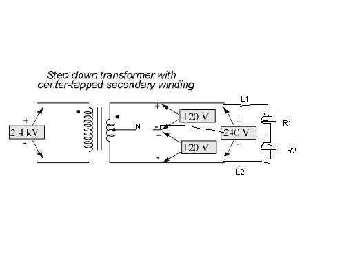

Here's a very crude drawing of a 120/240 VAC power system using a center-tapped transformer with the center tap being the neutral leg. The voltage across the outside legs (L1 to L2) is 240 VAC, but the voltage from either outside leg to neutral (L1 to N, L2 to N) is 120 VAC as shown. Now, if the N leg is lifted (broken), the 2 loads shown will be in series across a 240 VAC circuit. This could happen if N is lifted anywhere between the bonding strip at the RV's power distribution panel where the individual circuit neutral legs are joined together (i.e., the loose neutral case) and the transformer.
Does this help?
Rusty

Dan239. All things being equal, if all you used was two lightbulbs of equal wattage you would be right. But use a light bulb and an air conditioner in the same manner and that light bulb would pop instantly. The reason is the load and resistance is not equal. The AC would provide a better, lower resistance path to the light bulb and the bulb would see a 240V line and then BANG!
Even tho the designers of load center TRY make a balanced load from on side to another, its never perfect and they cant take into account what you plug into it. Only provide plugs for you. The known loads that are close to balance is the refridgerator, AC, invertor and water heater. Those are only balanced when they are all ON. The rest of the plugs are split up and purposely seperated because of location. That way its harder to bring two appliances together that may have the potential of shorting together with a 240V surprise! Then depending on whats ON and whats not will determine what kind of damage will happen when you loose a neutral.

I will agree that if a small bulb is on one leg with a heavy load, such as a 120v A/C, is on the other leg and both are on, if you lose the neutral it will probably blow the bulb as if it were a fuse. However, I do not believe the bulb will see 240v because the voltage will remain split between the two loads. The bulb will blow because of amperage overload. I do not believe that the bulb and the A/C will both see 240v. In electrical theory the only way they could see 240v each is if you had a 480v source.

Nope. It sees 240. The reason is again, two 120V lines on either side of neutral that are oppsite phase equals 240. The 240 does not need a neutral. The two loads married together on opposite 120V poles equals 240V across each other. Its real easy to verify with a volt meter.

I agree there is 240v across both loads in series. Surely you do not think there is 240v across each load. Any loads in series will split the voltage according to the resistance of each.
Based on what you are saying, each load would read 240v on a meter, it would read 480v across both loads. That would be very difficult when you only have 240v available.
The only way for each load to see 240v is if the are wired in parallel.
If we go back to my example of two 120v light bulbs of equal size wired in series in a 240 volt circuit. Are saying that a meter will read 240v across each bulb?
Yes and no. It will read 240 across both loads. If you lift the lead at the beginning of either end, or in the middle it will read 240V. The reason?, no neutral. But your running two 120V bulbs in series so no problem, providing they are the same. But the AC requires a LOT more amps to run than say a 40 WATT bulb. The bulb will not provide enough of a circuit to run the AC and since there is now 240V across the load, the bulb looses. It is 120--+--120 equals 240. The positive is on both sides and both neutrals are tied together in the middle completing the 240V circuit. The middle is SUPPOSED to be the neutral instead of being a jumper, but without the neutral connect to the supply, its 240V volts ACROSS the ENTIRE load. Without equal resistance on the equipment thats connected across the load, one looses. Kinda like a fuse. But if its a TV and a AC, both 120 items hooked in a series to a 240V line, the TV will blow, the loads are uneven.

I agree the load that is less will lose. If we talk about the 40W bulb in series with the A/C with no neutral the bulb will lose just as if it were a fuse. However, your saying it will blow because of voltage is not correct. Just like a fuse it will blow because of amperage being more than it can handle. All fuses I have ever dealt with blow on amperage not voltage.
