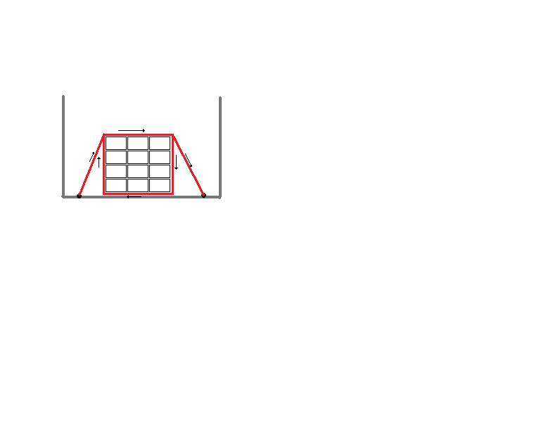

Originally Posted by Jaxom
And when you "bundle" the load, be sure to wrap your strap all the way around it. That will "choke" it so no individual piece slides out.
This is how I secure a load in the bed of the truck.
I also use ratchet straps, not the lightweight tiedown straps.

That's good stuff.
Thanks for the pic shovelhead.
