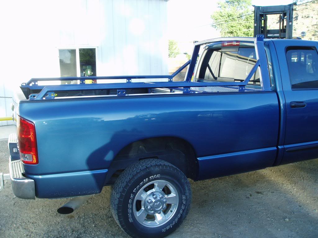

Bundle the materials together, use ratchet straps on the front and rear bed-hooks.. Padding is a must to protect the paint, anything 4' beyond the tail light requires flagging by day / lighting at night (in CO). If your going to do this frequently the first order should be metal for a head ache rack and tail gate protector.
Here is what mine looks like:
Note:

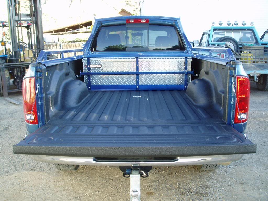

The middle bar (eye) bolts into the last (small) hole to protect the tail gate. The larger holes are for ratchet strap hooks.
There was another thread started on headaches that would give you even more ideas, do a search for it.

CRR, love the rack and rails. Very clean job. I'm eager to get some stuff for the truck built but right now I've got some firewood down on the ground that I desperately need to get racked, plus a makeshift rack that's holding all my cooking firewood that I'm afraid is going to tumble through the fence if a fat squirrel jumps on it again.
I do have diamond plate bedrails and a tailgate cap. I don't know how many times those have saved the edges from getting banged up. So best thing to do is bundle the materials and strap it in? Should the tailgate stay down for support or be closed?
I've helped dad build the stuff for our trucks before so I figure using the same overall designs. The other truck (not pictured) had the same rack, rails and tool box that, if weren't there, I'd have been crushed in a vehicle rollover @ 70mph on the highway. Talk about a real world test!
