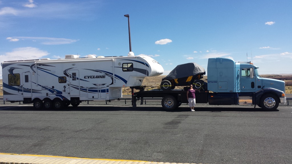

CrazyCooter's Avatar
Posts: 632
From: Redding, CA
Holy thread resurrection batman!
I'm still fond of running hitch behind the axle.......
Current puller with hitch placed 7' behind.
Only 4k miles behind the wheel, but no near death experiences and I can navigate the tight camp spots easier than the Dodge now since the 5er tracks pretty close to the drive axle.
