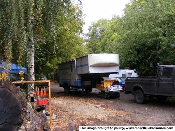

you might look for an old frito lay trailer thats what we have, ours has a wood floor with a fold down ramp, and my uncle has one that is all aluminium with 8 hole wheels he can haul a toyota in it
oh and ours is about 28 feet long
