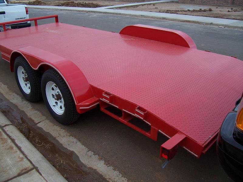

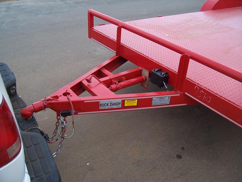

I have had a Buck Dandy for about 2.5 years and have been happy with it. It's built very stout. All the frame work is 1/4" c channel with angle iron crossmembers, even the ramp slides and tail light mounts are heavy duty. It has a Bulldog hitch and foldup jack. Only complaints I have is they didnt grind the torch slag off the front of the deck and the wiring connections weren't that great; both of which aren't that big of a deal.
My dad has a similar Big Tex and I'm not that impressed for the price he paid. He paid cash for about the same price as I did financed and he got it from an idependent dealer, who was a good bit cheaper than direct from Big Tex. The fabrication is good, but the kinked square tubing looks cheesy IMO. The front marker lights are mounted out to the side of the trailer begging to be torn off; mine are mounted up under the frame out of the way. The tail lights were mounted on sheetmetal brackets; mine are on 3x5x.25 angle iron. He had to build new mounts for them a couple months later because they were bent up. I have broken a couple tail lights myself, but atleast the mount was still there. The dove tail is a little too low and drags the ground pretty easy also. Dont get me wrong, it's a nice trailer, but I think it's over rated for the extra cost.
I have used and abused mine over many miles and the only problem I've had is keeping tires on it. But that's mostly because of cheap tires and being overloaded a lot.

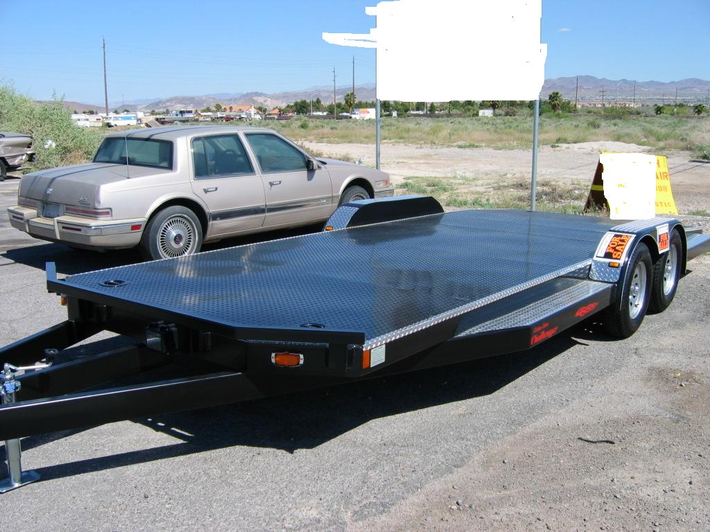

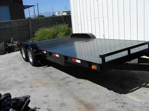

I could possibly set you up with something like these!
