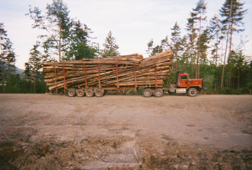

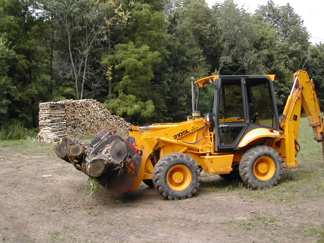

I agree. And God help you if something happens to the trailer brakes. It only takes one bad situation to change your life. I wouldn't chance it. I've been around trucks and heavy equipment my whole life, so it's not like I'm not used to hauling heavy loads. But hauling heavy and hauling irresponsibly are two entirely different things.
If that JD only weighs 16k, they've REALLY cheapened them up over the years. I had a Ford 655 that weighed over 20k, and my little JCB 210S weighs over 14k.
Just to give you an idea of how small the JCB is:

And yes, I've hauled WAAAY overweight, but never on public roads. The load in the pic below is over 200,000 pounds, but from the landing to the mill was all on private roads. I'd never do that where someone besides myself might be put in danger.

A 310 JD isn't much bigger than your 210 JCB.
