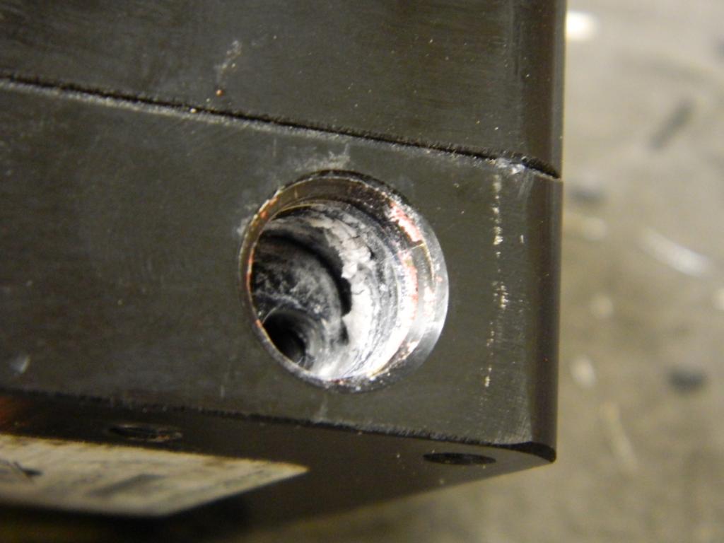

I think I found the problem as to why the manifold won't dump the right side bag. This weekend I could not dump the right bag as it was stuck at 100 psi in the cool morning. Then in the heat of the day combined with the added pin weight of my trailer (4500 lbs) the display read 173 psi! I hope I have not damaged my Pacbrake bags. I took the airlines off and found white powder inside the air line from the compressor (which came with the wireless air kit) had combined with moisture in the compressed air and made some kind of white crud that I can imagine has plugged the right solenoid valve.
