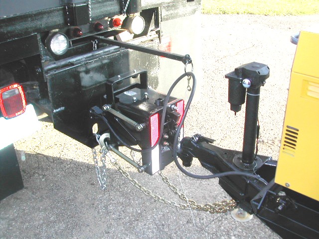

Me neither! Can you post a pic? If I can SEE it, maybe then I can point you in a direction!
I built an air hitch too, based on Oil Guy's design. His help made it easy!
chaikwa.
chaikwa.
Dude that looks great!!! Do you have any other pictures of it? What is the square tubing coming out of the top?
Tough part is getting the alignment right on the faceplate with the tie rods... After you have that right >> it is easy. Did you make it as a drop hitch or did you come straight out of the receiver?

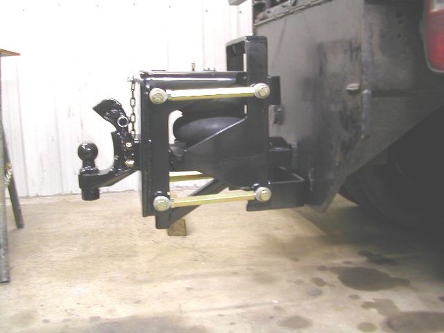

The square tube is a guide that keeps the face plate from trying to twist when you go around a sharp corner with a heavy trailer. Two pieces of heavy flat stock run vertically on each side of it and the whole assembly slides up and down on it.
I made it as straight out of the receiver. I originally had a piece of 2" solid plate cut to come out of the receiver, then drop down about 6", then go flat again to hold the air bag, then go 90* up vertically for the slide that the square tube now functions as. After I got it all together, I figured out that the drop was too much, , so I remade it as a straight set-up. I still have the other piece if anyone is gonna make one of these things and needs it. You can have it for whatever it costs to get it to you, weighs about 90 pounds tho!
Thanks for all your help Oilguy!
Here are a few other pics of it.
chaikwa.
Attached Thumbnails Advanced Air Hitch parts ideas-airhitch-003.jpg   Advanced Air Hitch parts ideas-airhitch-006.jpg   Advanced Air Hitch parts ideas-airhitch-002.jpg

I noticed that you didn't put shocks on it... Any reason? I had too much "porpoising" or oscillating at low speeds so I had to slow that down... Otherwise you can't beat the ride quality at all!!
It is really cool to hit train tracks or speed bumps and not feel any trailer shock what so ever!!!
