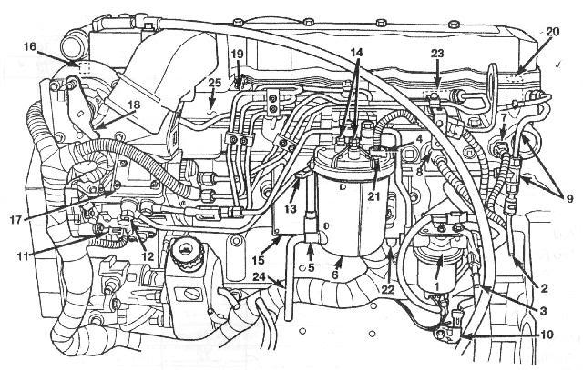

You shouldn't have the intank pump unless it was done under warranty by the dealer.
Airdog is a seperate unit mounted on the frame rail.
LP #1 in the pic.
