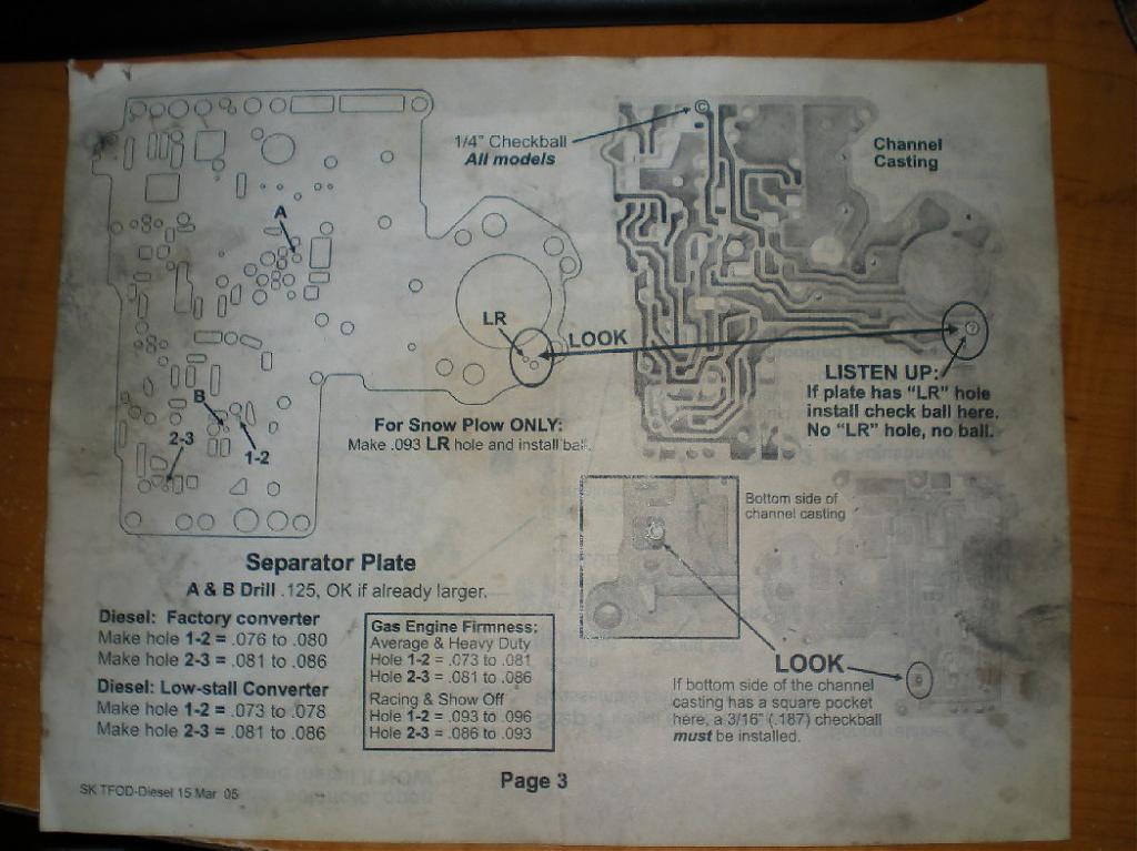

Have kit to install have lost the instructions.
If someone could post them or email them to me would be most appreciative.

this might help
http://www.transgo.com/Video/TFOD.zip

thanks but have the video from the home sit specifically need the page of the instructions that shows what holes to drill in seperator plate to firm up shifts, have the rest.

this better ?
Attached Thumbnails transgo sk tfod diesel shift kit instructions-sktfod-drill-guide.jpg

here is a couple more pages ya might need, DO the sealing rings so you can beef up the l/u, makes a big diff, you will need to get a new front pump gasket and oring tho. good chance to check frictions also.
Attached Thumbnails transgo sk tfod diesel shift kit instructions-vb-mods.jpg   transgo sk tfod diesel shift kit instructions-converter.jpg

Thanks a million JohnBer, just exactly what i needed.

I drilled my separator plate holes to the max and turned the pressure screw out 5 turns and the shifts were way to hard. So I bought a new separator plate, drilled the holes the minimum size recommended and backed out the pressure screw 3.75 turns. The shifts were still a little hard for my taste. Then there was something wrong with the tranny (ended up being a solenoid) and I couldn't seem to get the bands adjusted right so I ended up getting the whole thing rebuilt. I'm not sure exactly what the VB is set at now but if I were you, I'd say go 2 turns on the pressure screw and drill the separator plate holes to the min.
