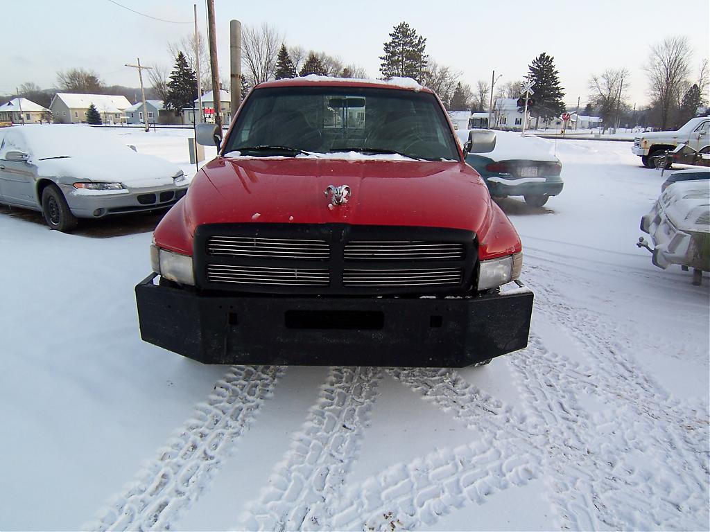

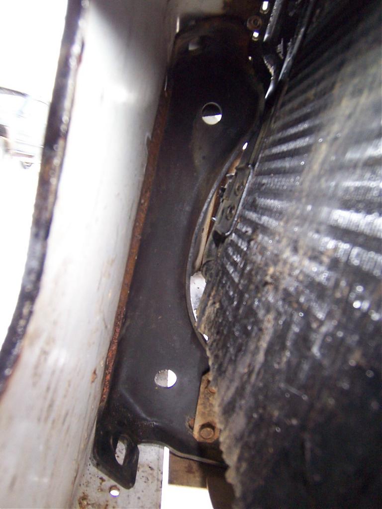

I just made my own out of a front bumper for an '82 International Medium Duty truck.... Quite a bit heavier (3/16" vs 1/16") and fits/looks well. It was 15 1/2" too wide so I took 7 3/4" off each end and welded it back on parallel with the body. After that I put the stock bumper mounts on the frame and balanced the bumper on them and adjusted till it was center. Marked where everything was as far as up/down and side to side then welded the mounts to the bumper. Put it on, closed the hood, and adjusted it up as far as I could without interfering with the hood and tightened everything down. Also, painted it black because it was white and had some dings in the paint that had been feathered out with a Random Orbit sander (for quite awhile it looked like I had demo'ed my truck and won )
So in all I get the big rig look (I have a semi running light bar on the bottom) with added structural rigidity without all the cost... Was free other than my time, but could be easily procured at a local junk yard for next to nothing.

ckt, can you post sopme pics of your bumper. It'll give me and I'm sure some other guys some new ideas !
Thanks

Alright I got my laptop back and those friggin geeks managed to delete half the stuff on my laptop @#$%^#@!@!!! Anyways I got a chance to take some pics today. I took a pic of the front appearance and then a pic of one of the brackets from both sides.
