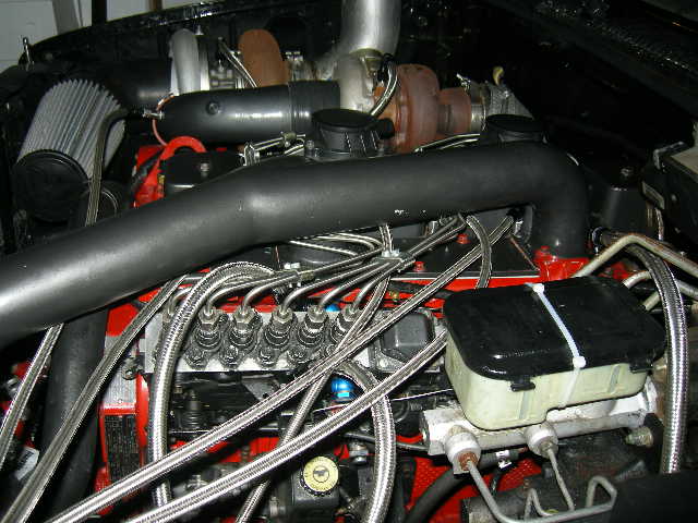

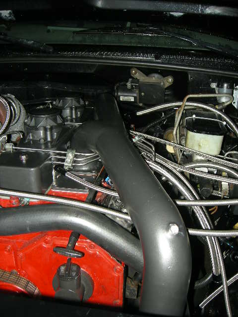

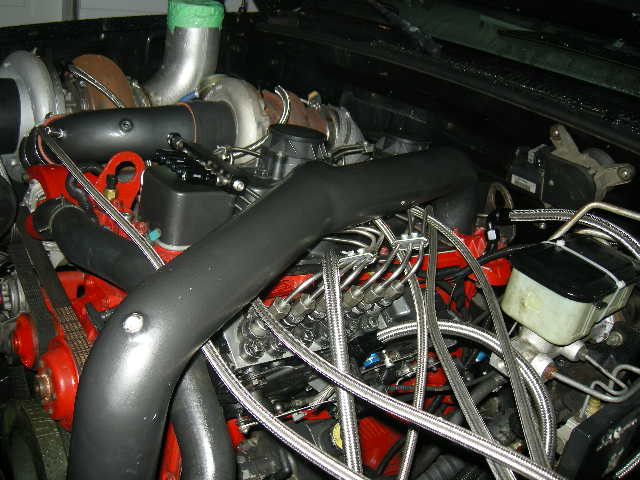

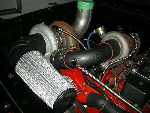

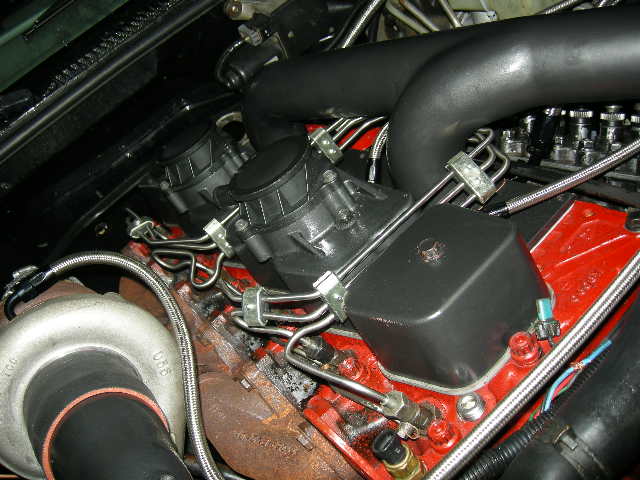

RyanB's Avatar
Joined: Jun 2004
Posts: 24
From: Ontario, Canada
Here is an update on mine. I now have everything in an painted and just have to finish hooking up my water. Turned out pretty good and I am really happy with it so far.
RyanB
