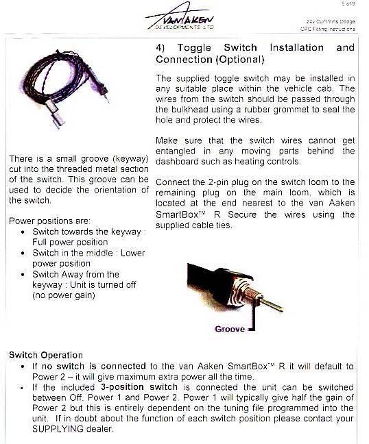

Question: the instructions for VA say that with an optional 3-position switch, the unit can be set to Off, 50% power and 100% power. How is a switch wired to use 2 wires and provide three positions? Does anybody have a connection diagram?

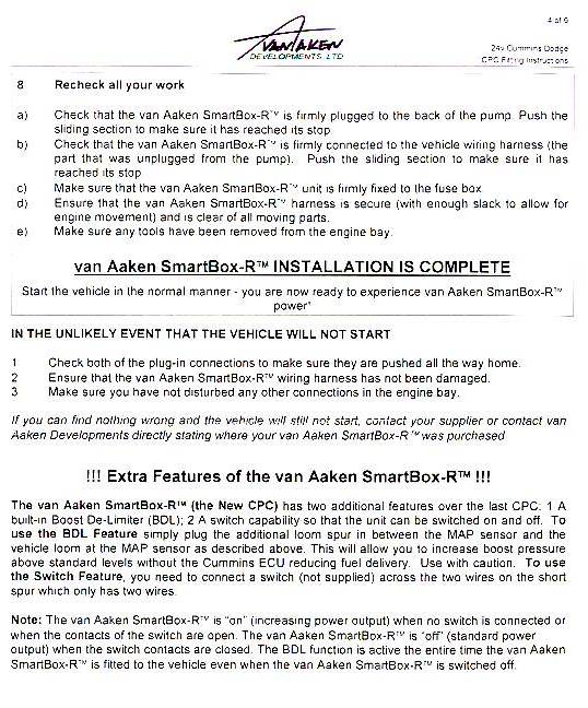

Well, here are the two pages from my VA manual that got me thinking. The only way this can be done that I can think of is, by installing a resistor on the third contact of the switch. I would like to know what the value of that resistor is... which would also mean that one could make the VA fully adjustable by using a variable resistor. I will keep looking for schematics or for someone who owns a 3-position switch, to ask them to measure it up.
The three-position switch may be a feature of the last batches of VA boxes that they made just before going out of business. Its a shame they did

Reading the Van Aaken instruction sheet leads me to believe that a resistor is used as you thought. Open circuit or infinite ohms gives full power and shorted or zero ohms gives zero added power. A quick ohm meter reading with the switch in the middle position will give you an idea of what size pot to try. For example if the middle position reads 1K ohm a 10K pot may work. If the reading is 10K ohm, I would try a 100K ohm pot. Generally in automotive circuitry they stay away from things much over 100K ohms because of the chance of noise pick-up problems with high impedances (>100K ohm).
