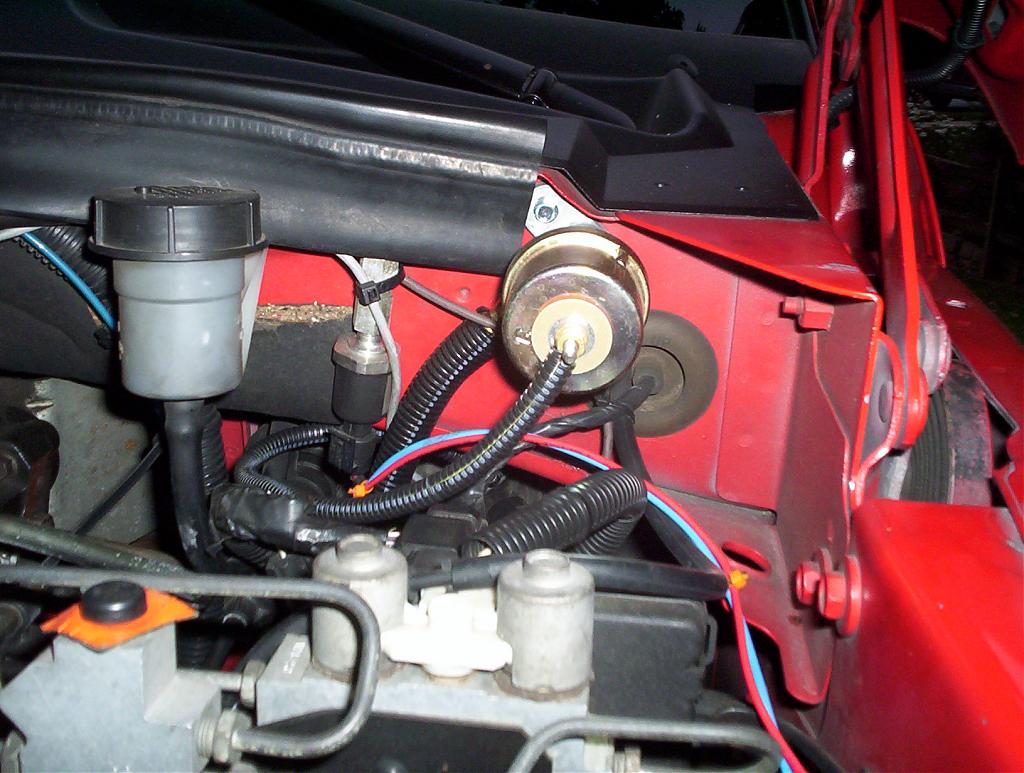

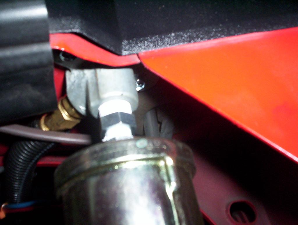

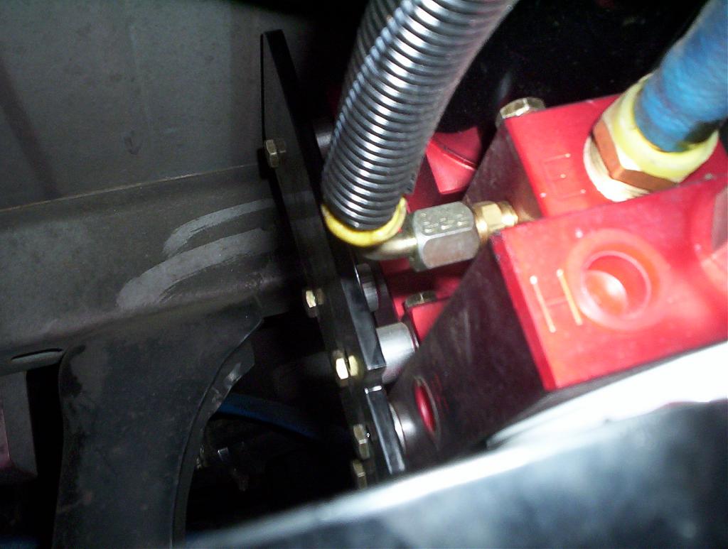

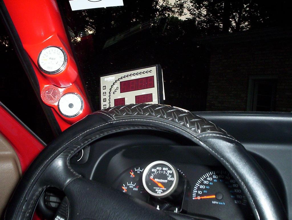

Here is how EEP did my fuel pressure gauge on my FASS which is installed on my 12v.The tapped into the port located on the FASS unit and ran push lok hose from there up to a fitting they have designed to hold the electric sender.They mounted the sender as you can see on the firewall amd ran the wires inside to the guage.Then we just installed the guage on the top of the steering wheel until I can find a steering column mount(seems most are out of them for the second gens or they are back ordered).The fitting they used to hold the sender is one they stock at their shop.This setup will give you your pressure at the Pump where it is more accurate.......Andy
