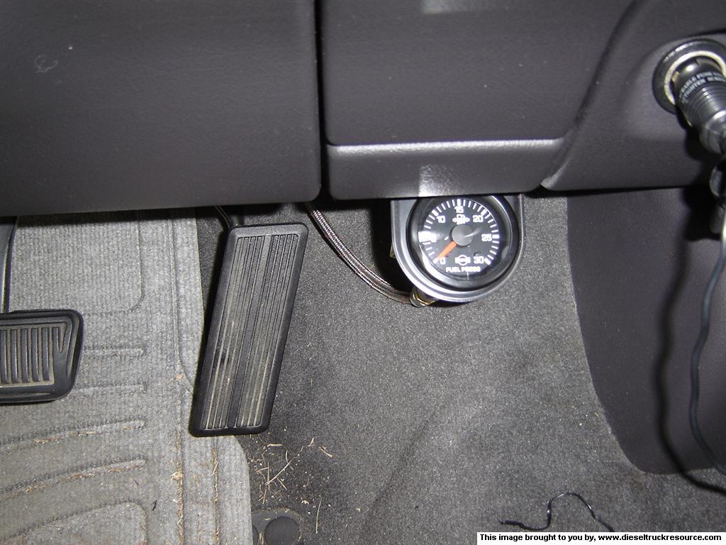

Another honorable mention for the ISSPRO EV's. Stick a green bulb in them and they look very similar to the guages on the dash.
I really hope your truck was turned off when you took that pic.
