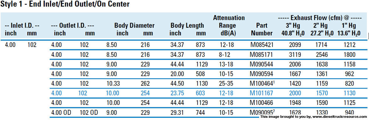

Still researching here.
I found this spec sheet on Donaldson's website. It shows size, Db attenuation CFM etc.....
I'm assuming that the higher the number on attenuation the quieter the muffler at least from this info.
The following table helps to indicate the order of magnitude associated with dB:
1 dB attenuation means that 0.79 of the input power survives
3 dB attenuation means that 0.50 of the input power survives
10 dB attenuation means that 0.1 of the input power survives
20 dB attenuation means that 0.01 of the input power survives
30 dB attenuation means that 0.001 of the input power survives
40 dB attenuation means that 0.0001 of the input power survives
Anyway there are higher attenuation choices but decreased CFM levels.
So what kind of CFM levels should we look for when adding a muffler to our trucks for maximum performance? I could decide to upgrade my turbo, add injectors, 3 GSK etc... so I don't want to overly restrict things but I do want to get as much silencing characteristics as I can.
