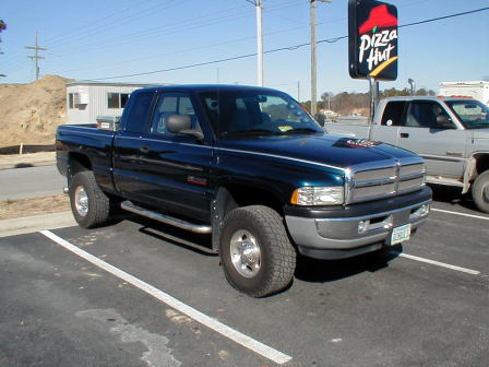

I am saying that TimInVa, a member here, has Nitto Terra Grappler 305/70's on his truck, and has had them on it since BEFORE he installed the leveling kit. He told me it only rubbed when at the steering locks. He only installed the leveling kit because he wanted the truck level. Tim's is a 2000.
Tim's truck. Only one I have on hand now, so I can't show you the clearance. This was before the leveling kit though.
