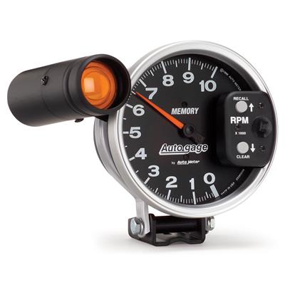

I always thought that "AutoGage" was AutoMeter's cheaper line...
Example:
http://store.summitracing.com/defaul...=egnsearch.asp

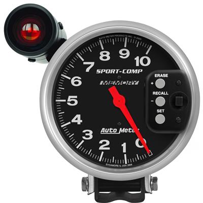

AutoMeter:

According to this http://www.elecdir.com/site/store/13253/index.html
Autometer's registered trademarks are: Auto Meter - Autometer - Auto Meter Products Inc. - Auto Gage - AMI - Battery Extender - Super Bezel - Phantom - Pro-lite - Ultra-lite - Shock Strap - C2 - Carbon Fiber - Cobalt - D-pic - Golden Oldies - Lunar Series - Monster Tach - Monster Tachometer - Monster Gauges - Nexus - Pro-comp - Pro-shift - Pro-tech - Sport-comp
The $8.95 gauges are coming from place that sells new surplus, doubt if you could get them that cheap elsewhere. Surplus Center's price doesn't mean the product is cheap.
Like I said, I was impressed with the AMI
