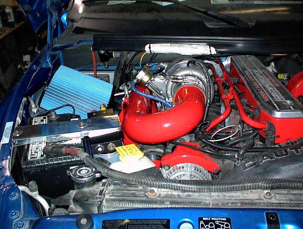

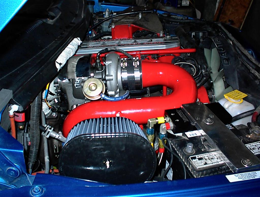

air flow systems has elbows, clamps, hoses, for hot pipe Fastenal. Make a flange or buy it weld it together.heres what mine looks like.I will build the heat shield next week.
Attached Thumbnails Building twins, S400 differences and parts suppliers on the cheap.-truck-rebuild-168.jpg   Building twins, S400 differences and parts suppliers on the cheap.-truck-rebuild-165.jpg

Looks good,what kind of air filter is that? I like the looks of the oval filter.
Old May 9, 2008 | 07:08 PM
renopker's Avatar
Posts: 210
its amsoil with the offset inlet
