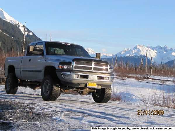

I have the 2.5 HBS Leveling Kit on mine, Pretty easy install, Didnt need any modifications.
Heres a pic
Heres a pic
Bbabic thanks for the picture.... Trucks looks great..

i swear it looks like my truck already sits up in the frt compared to the rear...I couldnt imagine just raising the frt up and not the rear, but your truck looks nice and level
