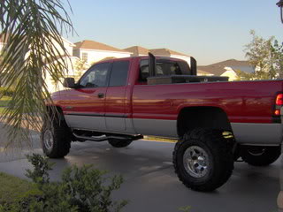

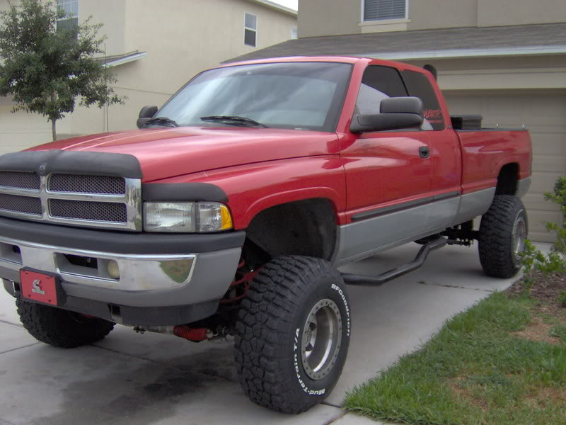

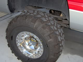

3 Attachment(s)
I run 16x12 MT classic locks and they are great! Some of the 315-75-16's are 34" tall and would fit with just a leveling kit. I would NEVER buy 16.5 rims, I dont know why they continue to make them. Here are some pics of mine...
On 35x14.50x16 Pitbulls when new
http://img.photobucket.com/albums/v2...truck01004.jpg
Attachment 75479
Attachment 75480
Now on 315-75-16 BFG KM2
Attachment 75481

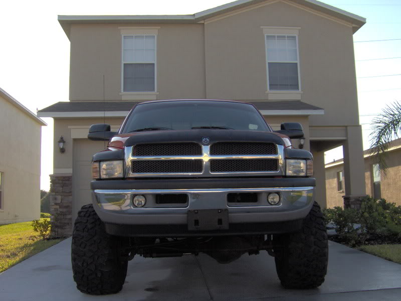

JIT Dec 13, 2008 07:12 PM
1 Attachment(s)
Originally Posted by ted_pulliam (Post 2287226)
JIT, your truck looks really good! Do you have any head-on pics of the truck? The 12" rims don't seem to extrude too much from under the fenders based on the pics you posted.
How are your wheel bearings in the front? Have you noticed any extra bearing wear since adding the 16 x 12's?
Ted
No, I havent had any problems with wheel bearings and I run 4 wheel drive more than most would.
Heres a head on pic but these tires baloon out because they are 14.50 wide....
Attachment 75490
