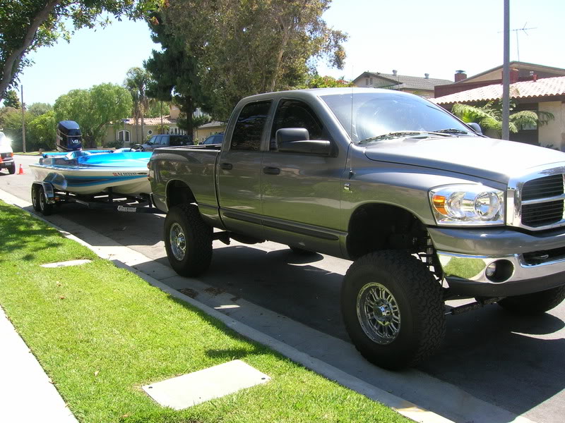

Riverbound Nov 5, 2009 12:15 AM
2 Attachment(s)
I had a similar set up on my truck and ran 37"s with no issues. I did have 39.5"s on it and there was some rubbing. I had the 6.5" superlift with 2" spacers. the main issue will be with the fact that the arms may have to be modified and lengthened to obtain the correct geometry. I had to do that to my Kit.
Attachment 71609
Attachment 71610
http://i26.photobucket.com/albums/c1...Picture005.jpg
