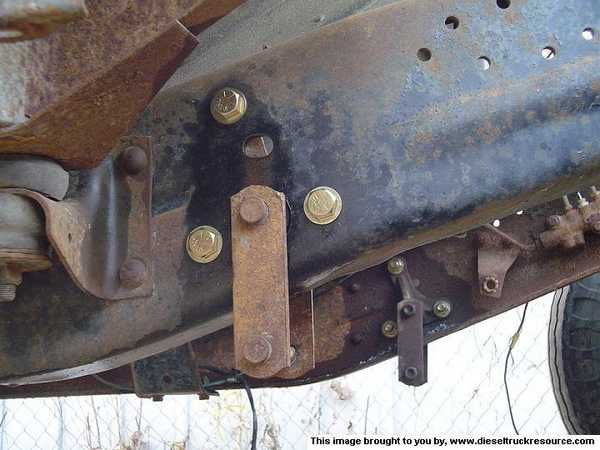

Your doing a nice job on your conversion. I also used the 1/2" right angle drill to open up my holes when we installed the HD bushing assembles. On a side note they can be had with the 5/8" greaseable grade 8 bolts now. That should help with the weight of a CTD.
Attached Thumbnails My 2wd frame just got an upgrade....-stock-shackle-flip-022.jpg
