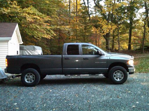

I picked up some H2's with stock tires and installed them. Love the look, ride, and fuel economy and RPM range with my 4.10s.
I'm about to pull the trigger on some Dynatrac Prosteer ball joints so I never have to worry about them again. Theres a group buy over on dieselbombers forum for 565 shipped and I'll install them myself. I'm trying to figure out if my one loose upper is within tolerance or not, but I'll try to pass MD inspection tomorrow without changing it.

Truck looks good. I'm assuming the wheels were already machined for your truck?

Thanks. Nah I did the flush-cut router method to mod the rims and did the center caps on my table saw.
