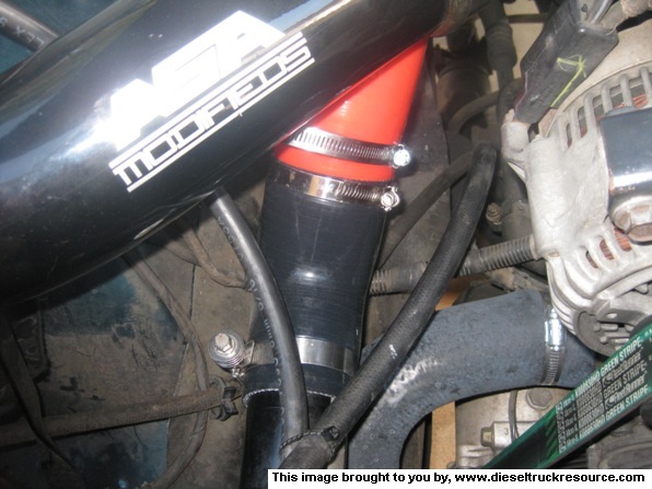

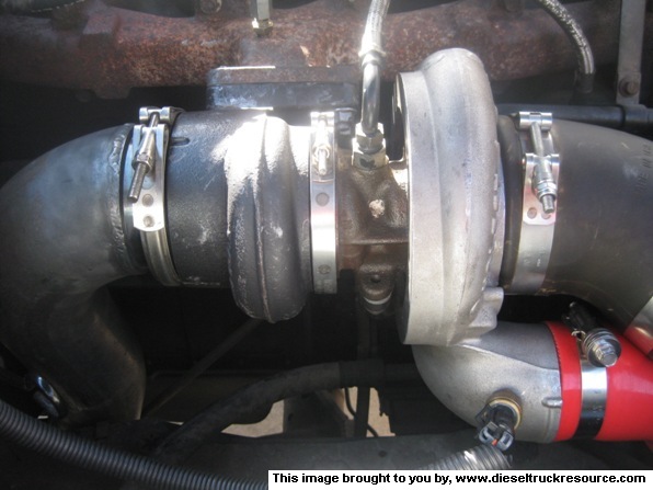

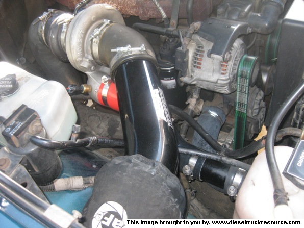

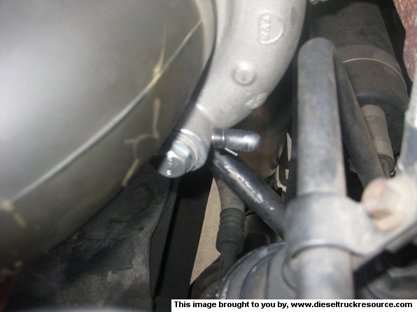

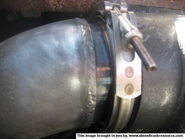

So I have had a rebuilt351cw sitting on my bench for a few months. Just getting over a Rotator cuff rebuild in the shoulder so I have been out of operation for about 5 months. Finally started getting it together and bought the flange from Jacob. I bought a 2.75 to 2.75 elbow (45 degree red) from "Silicone Intakes" and a 2.75 to 2.5 elbow reducer (45 degree black) along with the stainless joint between the two. I did this to make up the 3" or so left after re-clocking the turbo to the intercooler pipe. I cut about 4" off the intercooler pipe to fit the silicone boots to the right length. Wastegate is tacked shut and the rod assembly removed by the PO. Drilled out the turbine holes and replaced the studs with new ones. used new "flange" bolts on 3 of the studs and a "jam" nut on the left/top stud because there is not very much room to work with between the turbine and the stud end. Cut the end of the DP and welded the flange on. Plugged the Solenoid hole and the nipple on the housing. The oil drain pipe and oil line fit straight away. Took about 6 hours. I have POD's and would lay down a good screen putting the pedal down hard and now there is literally no smoke jumping to 35 pounds. She whistles something fierce. Here are some photos of the finished product.

You are correct "Biltit". Had to put that boost gauge sensor somewhere.

I like your install but I HIGHLY recommend replacing those worm drive clamps for nice TBOLT clamps.

PapeCat, I already replaced them with T-bolt clamps. Blew the worm drives right off the first day. you are correct sir! Anytime I can return the favor and help anybody on here with anything i am stoked!!
