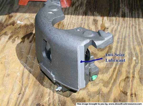

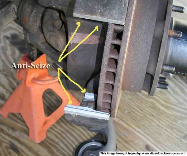

I've always used high-temp anti-seize and never had any issues.
Ref ~ https://www.dieseltruckresource.com/...d.php?t=143024

Awesome, thanks guys. And thank you David for the pictures. The main reason I asked is because I have a large bottle of hi-temp anti seize that I use for other stuff already. Thanks for the info.
