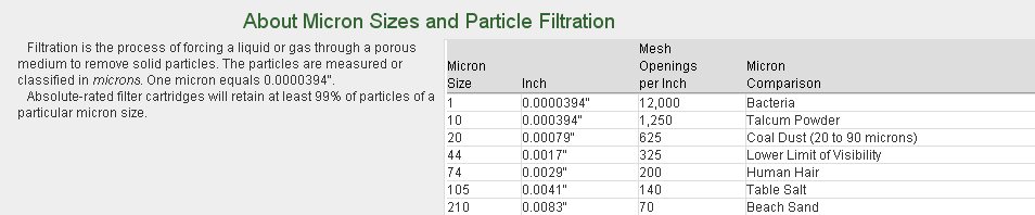

I looked at McMaster i am surprised the need to go down to 1 micron! It says, relatively, that 1 micron is the size of bacteria! Thats pretty freakin small.. LOL If 10 is the size of talcum powder what is wrong with getting a 5 micron filter like this (99%) efficient...
http://www.mcmaster.com/#4358k41/=rgxmh
Or the 3 micron ones listed above...?
Here is the reference from mcmaster on micron ratings (see attach)...

Also i would be careful to make sure what efficiency the filter is rated at... Your 5 micron filter may be only 70%. The 3 microns i found are 99% efficient.
Here you go...
In spin on they have down to 3 micron "standard efficiency" and down to 5 micron 99% efficient. If you drop down farther they have "Extreme-Pressure Hydraulic Oil Filters" they go down to 3 micron for 99% efficient (High Efficiency). Although the housing is a bit expensive.
