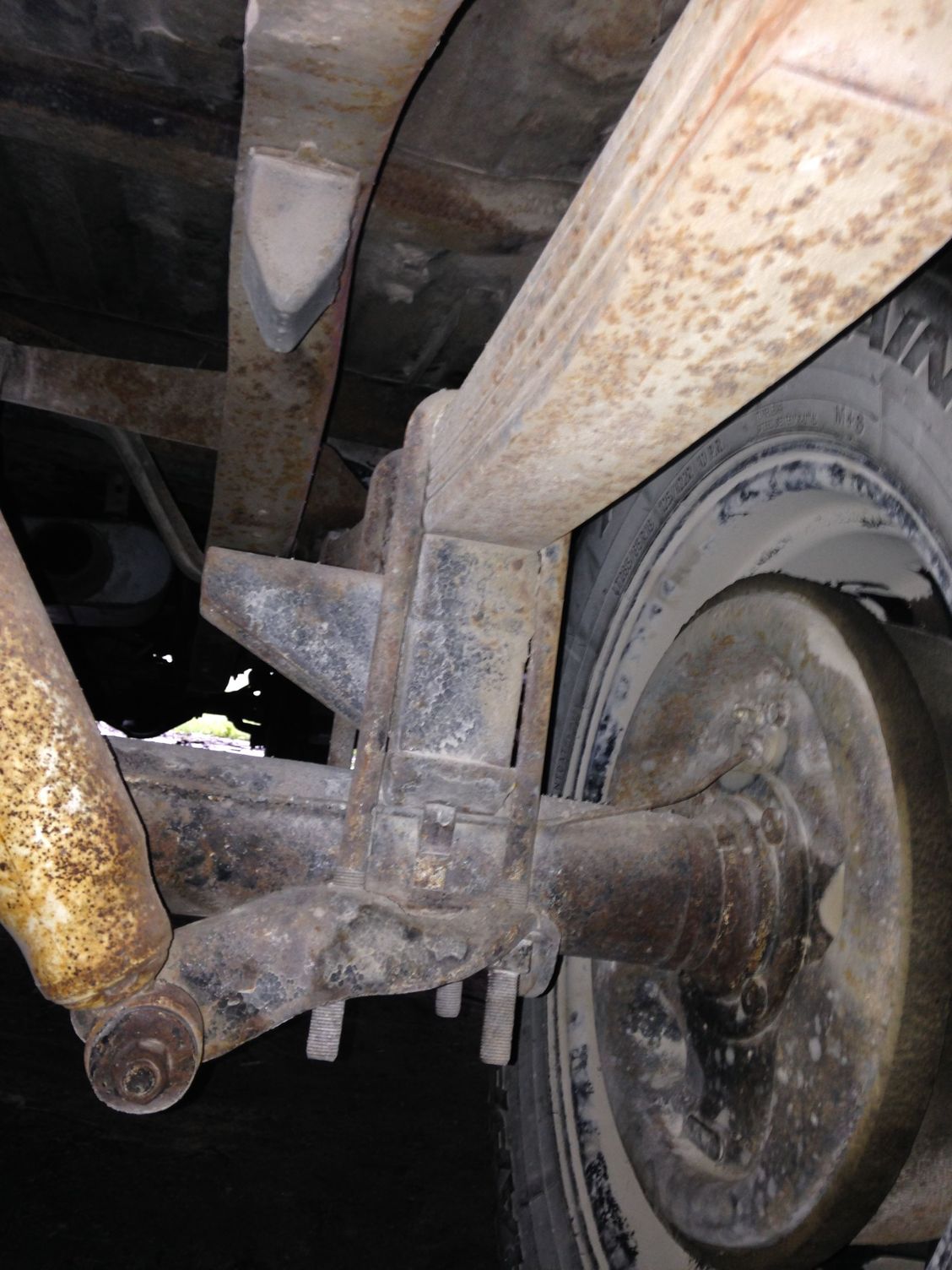

I climbed up under Big Red and found u-bolts to be 1/2x3.25"W-9"L on drivers side front. Passenger side front 1/2x4.25"W-9"L.
Rear 1/2"x2 5/8"W-12"L. 5/8 upgrade would run me close to edge of plates. May have to go 9/16". Regardless I think I need suspension. I'm trying to load some pics.

I was planning on it. Been having trouble finding ubolts. Thought a heavy truck shop that makes them could make me a set. Didn't have the dyes to do them. Parts houses don't have them and don't show even the half inch ones that are on it. Anybody know a kit for Dana 60 front and rear.
#40
Edit: There's a company in St. Louis called St. Louis Spring. They make springs, re-arch springs, and make ubolts. That's all they do.
They have made ubolts for me in the past for my Jeeps. If you can't find any with the lift kit companies, I would contact them. With you being in MexMo, shipping won't be that much.

Originally Posted by J10Mike
I would try the lift kit companies. I bought mine from Superlift. But, that was like 8 years ago. Superlift, Rough Country, Skyjacker. I'm sure at least one of them has ubolts. I would order ubolts for a W350 with rear lift springs. If you order standard rear ubolts (for factory block), they will be too long. You also might try Summit.

St. Louis spring is where my friend gets stuff for school district garage. May try them. Skyjacker has been totally useless. I've contacted them 5 times and only got 2 responses and the second told me to contact a vendor. I asked them how they would know if you (Skyjacker), doesn't. Looked up every part I ordered and crossed them myself after I deciphered their part numbers. Thanks for the info. Had forgotten about St. Louis spring.

I'm and EDC guy and was told that before. STL getting rough all over. Have a quick question about ubolts from earlier. I believe you were saying my rear ubolts would be to long. Do I need to remove rear spring block or does it stay. I thought it would stay. A little help. Appreciate it.
