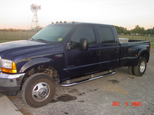

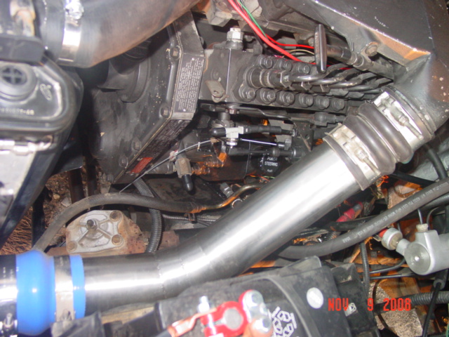

Just a quick note to say that my swap is done. Well, 99% done. I'm still needing the 4" exhaust. The truck runs and drives nice and everything works. Yeah.
I want to pass along a GIANT THANK YOU to Tim Martineau AKA MO Smoke. Without him I dont think this would have been accomplished. Very smart guy and does he know the super duty wiring!! ThanksTim
Here are a few pics

lews930:
Looks great Sir! Glad to see you finally got it all finished.

From: Manitoba, Canada
Hey that looks nice. Was the KDP addressed before you installed the engine?

From: Wes Taycksus Ya'll
Glad to see you got here in,..how much room did you end up with between the fan and rad?
Been wonder how this was goin
Old Nov 11, 2008 | 06:33 PM
lews930's Avatar
Posts: 353
From: florida
To answer a few questions. I kept the 4R100 tranny and used a PCS tranny controller. A bit tricky to program correctly but it is a really nice piece. I did fix the KDP prior to engine install. As for fan/radiator clearance I think it's 1.5" to 2". Had to clearance the fan shroud on the drivers side as well. I cant say enough about Tim Martineau. His patience while helping me out and keeping me on task with this swap was amazing.
I discovered a lot of things while doing the swap that future swappers might want to know before beginning their swap. One big thing, if you think you've asked enough questions, you probably havent. Dont be afraid to ask me as I found out the hard way
thanks guys
lewis

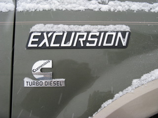

Does your A/C work? Tach? I have had a few double takes from Ford guys when they hear my excursion start up and to remove all doubt I installed these.
Attached Thumbnails anybody running a 12 valave in a superduty-c-excursion.jpg

The tach works perfect. I bought the kit from Destroked. There's another thing I learned. You should install the tach wheel and pick up prior to installing the fan shroud!!! If you arent running a shroud then no problem.
