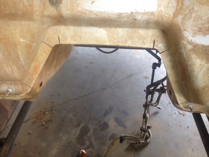

Stock down pipe with the first bend cut out to fit. It's still close the the firewall. I'll clearance the firewall, probably with a calibrated ballpeen, and wrap the pipe.
Pinch weld cut before folding over for added clearance around bell housing.
After founding pinch weld back.

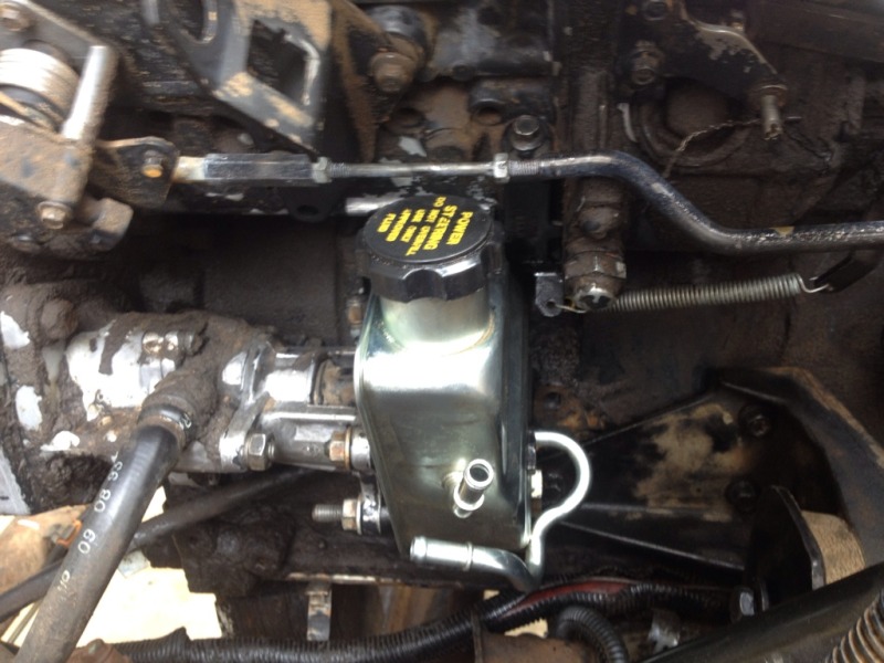

Today turned out to be a really slow day for me, so I decided to tackle the power steering and hydro boost issue. The chevy came with hydro boost and the cummins did not, so I wanted to figure out a way to get the hydro boost working without spending much money.
The first idea I had was to just plumb in an extra return line on the original pump mounted on the cummins. My better judgement told me that there probably wasn't enough fluid capacity, and there is probably different valving required to get enough volume to run a hydro boost.
So here is what I came up with. The stock pump on the 2500hd is basically the same pump as the dodge unit except for an obviously different reservoir, and probably different valving. But it wasn't as simple as just mounting the 2500hd pump on the cummins because the cummins pump has a machined surface around the shaft seal to allow the pump to be mounted inside the adapter that mounts to the back of the vacuum pump.
So I took the guts out of the 2500hd pump, put them in the cummins housing, and installed the 2500hd reservoir for added fluid capacity.
Cummins left with machined housing, 2500hd right

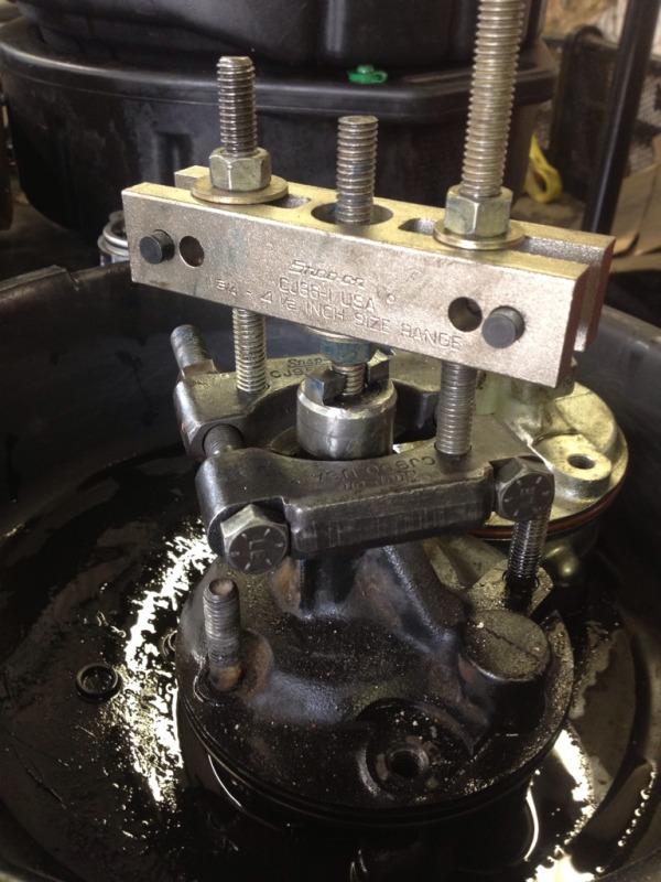

Pressing the rear pump cover to remove snap ring
Pulling the drive adapter off cummins pump to remove internals. Dang puller probably took me 30 freaking minutes to figure out. My two jaw puller kept slipping.

Pump mounted.
I had to modify the return spring bracket to allow the larger reservoir to fit, and the bracket must be removed each time the pump is removed. It took a little time to figure out, but it should be well worth it when the trucks brakes work as designed. At least I hope so.

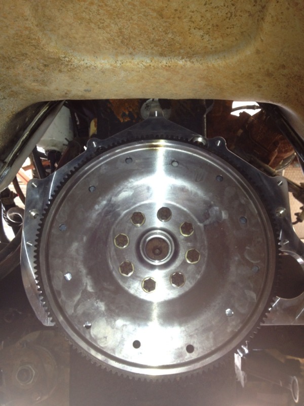

Well I decided to scrap the dodge trans idea and go with the 4l80e. My idea behind that is I want this truck to be user friendly. I started looking into the cost of running a stand alone controller on the 48re and the costs are pretty steep. So I bit the bullet and got an adapter and flywheel for the 4l80e. Stand alone controllers for the 4l80e are pretty easy to come buy.

I got the truck back in the shop today. I got the adapter installed, mocked up the tranny. I didn't realize I didn't have the correct dowel pins for the trans, as the adapter came without any hardware. So I need to track those down, but everything fit really nice.
I got really lucky with the transmission cross memeber. My setup has moved the trans back an estimated 2" (I have not measured yet). The frame of my truck has provisions to move the crossmember back about 2", I'm assuming for other trans configurations from the factory, but the holes lined up perfectly for my setup.
The new adapter uses a ford 6.0 starter on the passenger side of the truck.
