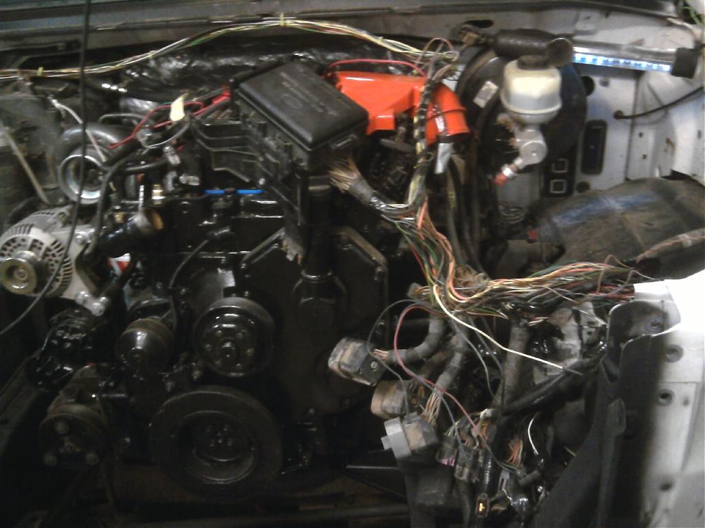

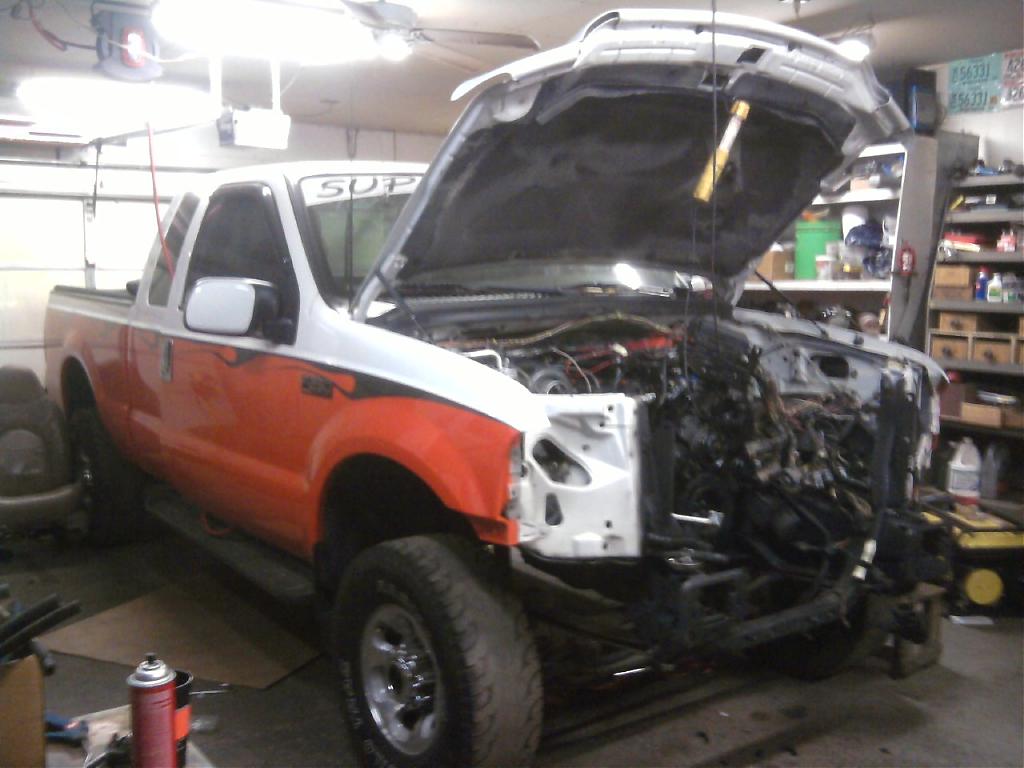

I've been reading posts on conversions on this forum for well over a year now, and the help is been incredible...Thanks! Anyway, I tore the 5.4 and auto trans out, and have the 12v and manual trans set in, and in the process of hooking everything up. I was wondering what you guys do for throttle cable? I have the one from my gasser, but its really long. Also, I wasnt thinking and I sold the wiring harness from my 5.4, and I'm trying to tie into the factory harness. I was wondering if anyone had and advice for me.

Hey guys, sorry to be a pest about this...but still wondering if someone could help me with the throttle cable issue? I've looked around and I still cant find any information on it. Thanks again.

I used the Ford cable. I took the end plastic piece off the cable, cut the cable sheathing off to length and put the plastic piece back on. I shoe horned the Ford plastic end to fit the bracket on the Cummins. Then I looped and crimped the cable around the the ball where the Dodge cable was attached . I did what came to my mind at the time often thinking that its probably temporary, but if it aint broke...

A throttle cable out of a 1st gen or second may work, I don't know what type of distance you are working with. As far as wiring , I would get a diagram from a second gen. and adapt....

get a throttle cable from a 2nd gen dodge diesel truck. bolts right in! perfect length too
Give MoSmoke a pm. he knows all about the wiring!!!!!!!!!!!!!!!!!!!

Thanks guys!...Im gonna call the junkyards around me tomorrow and try to find a Dodge throttle cable, if not, ill have to do some more thinkin on how to shorten my Ford cable.

Im in NW Wisconsin, and no I havent gotten ahold of MoSmoke yet, but I do plan to. I have the stock intercooler tubes and fittings, and it looks like they will line up pretty close to the Ford i/c... if not, my buddys shop has a mandrel pipe bender and I have a tig welder if i need to patch something in. As far as rad hoses, I got a top rad hose from an 01 cummins, and just chopped some off and it lined right up. And for the lower, Im just going to patch my ford and dodge ones together and go with it from there. heater core lines were a piece of cake too. I still havent gotten my turbo to move yet to rotate it, but it looks like the top oil line will still work, and my lower one will just need a lil massaging to work, but i think the length is good.
On a good note, I finished up my dual battery tray last night and got it mounted up in the truck, as well as my new alternator bracket (didnt like my quick one i had before)
