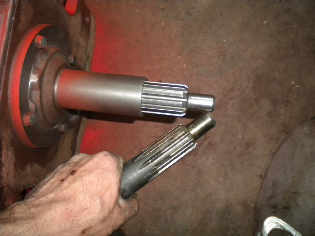

And the big input beside the little input shaft.
Attachment 69949
That's all for now, hope these help anyone else in the same process. Lots to do yet before it's all done--like my 2/0 welding cable battery cables [coffee], intercooler tubing, piston lift pump, etc.
