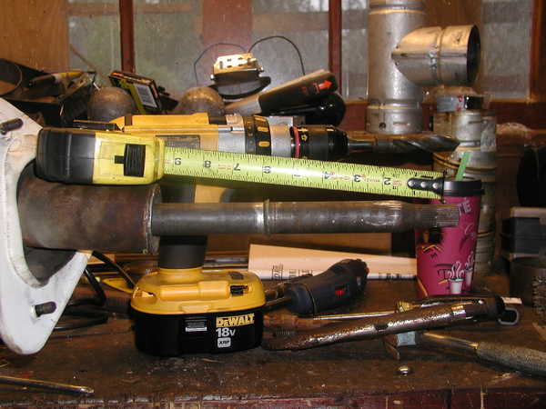

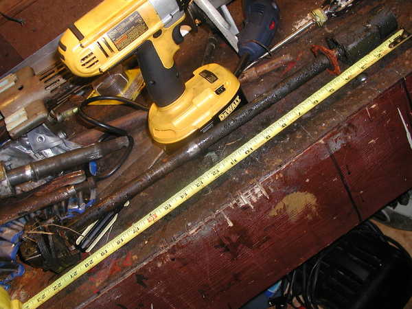

I got a call from Bobva today alerting me to a serious safety issue with Borgeson steering shafts, and he wanted me to bring it to everyone's attention.
Bob's Borgeson shaft telescoped (all by itself, no impact) and allowed the column to fall apart - meaning he had no steering! Luckily he was at low speed in a parking lot when it dropped, so he was able to get the truck stopped before he hit anything. He was not able to get anyone in tech support at Borgeson today, but I'm sure he'll chime in and let us know when he gets through to them.
He emailed me some pics:
Column in the stock position:
Column ready to fall apart:
Pic of the stock shaft with a tape measure. If your Borgeson shaft is shorter than this, you may be in for a nasty surprise! Go out and measure right now.

Bob's is a double U-joint shaft, but as long as it telescopes I don't see why this can't happen.
When I rebuilt my stock joint, I noticed that I had to shove the column back together to get the shaft in, so Bob's truck is not the only one with a column that will fall apart without support from the steering shaft.

This has me thinking you see the collar directly below the boot and zip tie in this photo? could you remove the boot and slide the collar up to meet the outer telescoping piece and just lock it in place with the Allen screw preventing it from sliding back down. What do you think? It almost looks like it was made that way but I have mine just like this photo and have no issues.

that collar should work. Im tack welding mine next time. plus after a more longer look at steering column. I think I see what real problem is. The two ujiont shaft you start with taking a hammer and punch and remove roll pin and the rag joint bracket. Idont think Dodge ever intended that part to come off. well with all that tappin that broke louse the plastic break away conection inside the steering column.
Just keep an eye on it.
Oh were did you get that collar at? I didn't get one with my kit! All I got was the two ujoints and the shaft.................

the stock shaft is solid it wont colaps the borge is two piece it can colaps if your two piece column lets go.
I truely belive if the borgeson was a solid this would have never happend.
when I put this back to gether it will be welded plus other improvements
