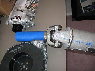

PAPerformance out of the US make one for us second/third genner guys----don't know about your year.I have one sitting here on my desk(200AMPS) for my 2001,never got around to installing it yet----125AMPs @ idle,185AMPs @ 1400RPM,.Paid a pretty penny for it though---329.00US.Hope this helps DW---PS--- picture is from my parts desk---always full of stuff i buy until i get around to the "PROJECT"..
