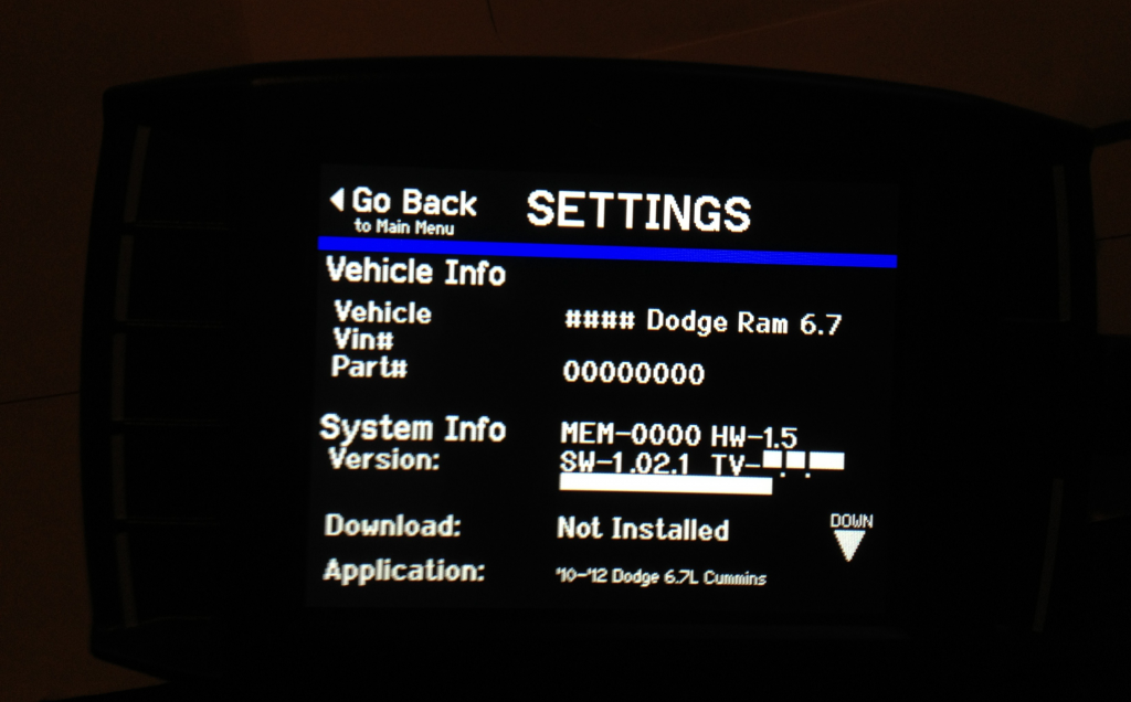

Yes, I just double checked all 5 sensors are unplugged. I believe I have a communication problem. When I power the tuner on, I see initializing communication, this never goes away until I hit the menu button. When I go to settings I see this:
Attachment 55526
I have been trying to limit my driving with the check engine lights on due to the exhaust sensors but I will need to drive it tomorrow. I am going to try to update the firmware since I noticed the tuner was packaged in October and there is a new update out as of December 5. I am hoping that works and I can delete before work. If it doesn't then I will be calling H&S tomorrow.

An update to the problem I am having. The mini maxx has been freezing when I get to the Loading engine tune. I have connected the power wire to the fuse box and I am able to see the truck when I jiggle the hdmi cable first. I am not sure what else to do. I have contacted H&S with my updated progess. Hopefully will hear something in the AM.

Today I received the new OBDII to hdmi box that H&S sent me. I was finally able to install the tune and so far no problems. I took it for a quick drive but had to stop due to the holiday. I will revisit tomorrow. The exhaust message to see dealer now is still on but I will clear the code tomorrow using the mini maxx. I wanted to thank everyone for their help. Have a happy holidays!
