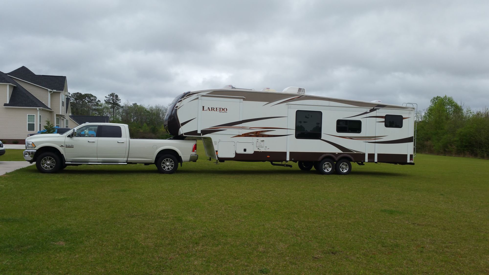

^^^^^ couldn't agree more.... John knows these trucks! Here is mine, and EGT is on order....
