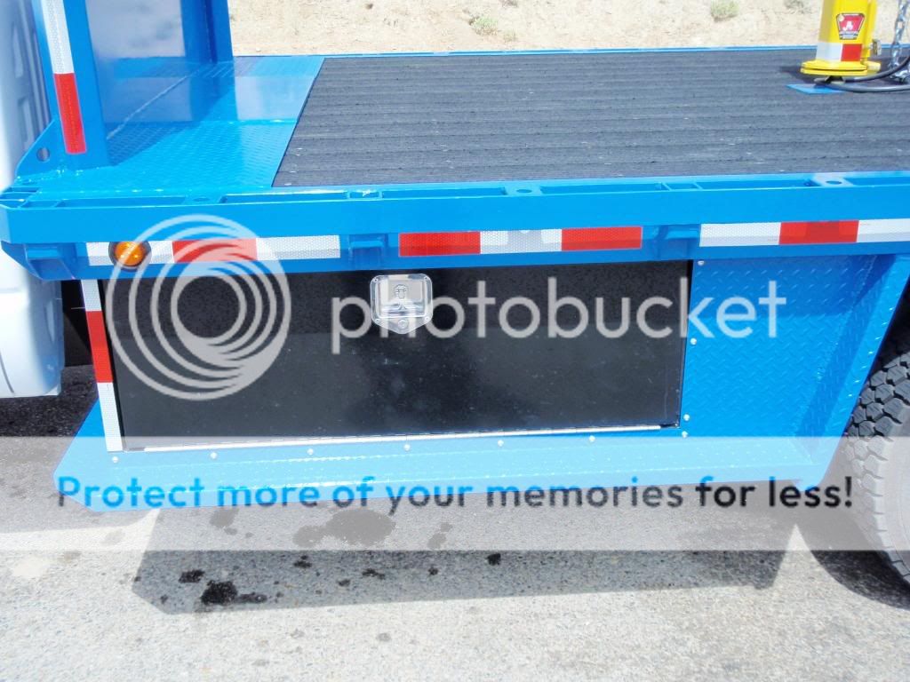

If you want some interesting conversation with the folks from B&W tell them your going to elevate the 1500 1 1/2" to facilitate a Rumber deck... , I added a secondary latch for safety..
Hooked UP..
And Haulin'

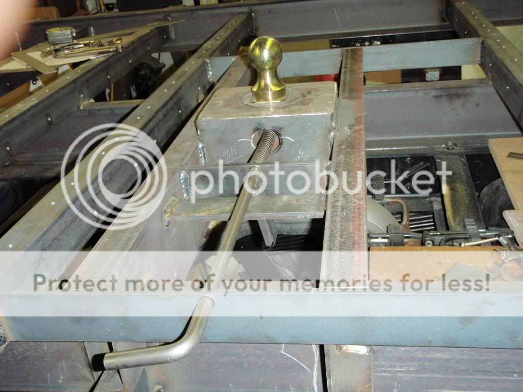

Colo_River_Ram, did you build that body yourself? Very nice bed. I like the 2" receiver tubes built in the corners of the skirt. I also like the ball protruding from the bed when you need it. I had a hillsboro on my 01 cummins, with a trap door covering the ball, which was recessed below the deck. Yours looks alot nicer. What is the decking on the front of the body?
Ben
benito is offline
Old 02-21-2009, 03:18 PM
With age comes the cage
Colo_River_Ram's Avatar
Join Date: Jul 2007
Location: The Gas Patch
Posts: 2,710
Received 1 Like on 1 Post
Thanks Ben,
Every socket on that bed with the exception of the GN is 2" slip / receiver tube, I used a 20ft stick on the project. I like the 2" slip tube tube as you can build slip in accessories. I have a pipe and regular vise mounted to a bracket that slips in the sockets. The holes on the rub rail brackets are for the hook style ratchet straps. the truck bed and the trailers I built in the sig line are identical in width so that all accessories will interchange .. The winters are long in Colo. so you build things to keep cabin fever from setting in..
The front of the bed is set up with 1/2" plate in the middle for an upright hydraulic winch.. the rest of the bed metal is 3/16" tread-plate the fenders / running boards are 1/8". My trap door gives me access to trailer hookup socket, electrical connections for the bed / trailer and I positioned it over the LP as well.. The two 3" square holes under the rear center marker lights are the socket tubes for the winch poles when I get the winch mounted.. Future plans also include a hydraulic driven welder and air compressor. A custom built bumper / grill guard with hydraulic winch for the front.
topped offed with fuel the truck weighs in at 10,800..
