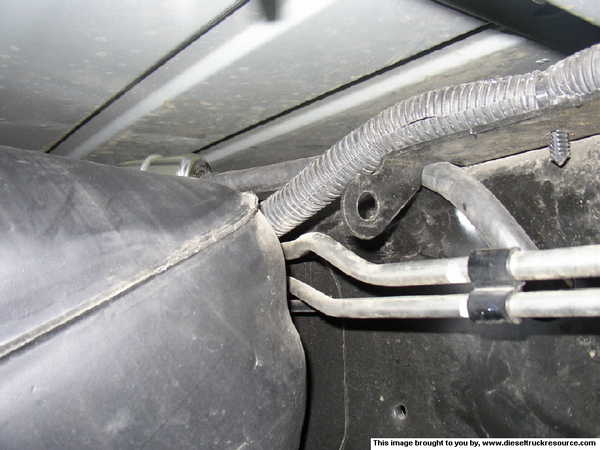

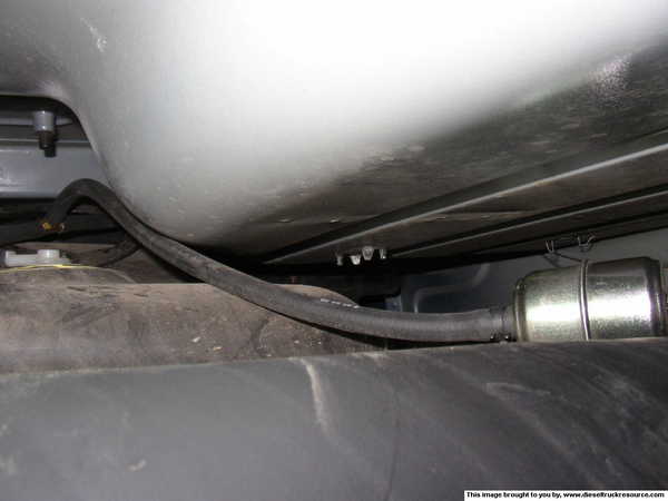

Simply Install the 1/4" fuel line hoses to the vent tank barbed nipples and connect them with the barbed "T".
Then run 1/4" hose to the fuel filter. Now use the 5/16" hose from the fuel filter and run the line to the hole in the frame rail. Like this, it will prevent WATER or other debris from entering the line. Also, as seen in the picture, RAISE the line going from the fuel filter to the "T". If (most likely NEVER) water would get in, it would make it harder for it too climb up the hose.
Also, as seen in the picture, I tucked the 5/16" line hose in the bracket that was already there. MAKE SURE the bracket does NOT have any sharp sides to it. I checked mine and it was OK. If it is sharp, it may cut the fuel hose, not a big deal but it is better to have the fuel line hose running INTO the frame rail where it is less likely to pick-up water or debris.

Yes, the 1/4" line will fit over the 5/16" fuel inlet line. The reason I went with the larger size was to get the volume needed since you are connecting TWO 1/4" lines into one.

NO, the tank does not have to come down.
It is very easy. The rear vent is accessed via the drivers side rear wheel well area. The front vent is accessed via the drivers side front area, next to the driveshaft, very easy.
It took about 45 minutes. It can be done in 15 minutes but I work slow...
