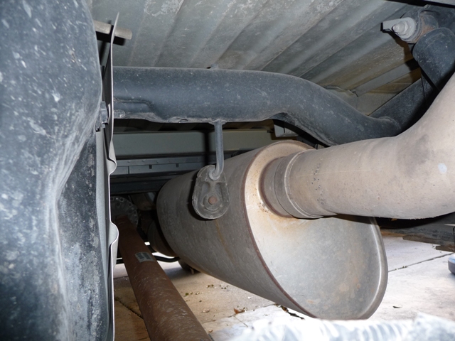

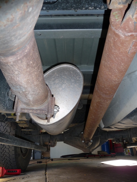

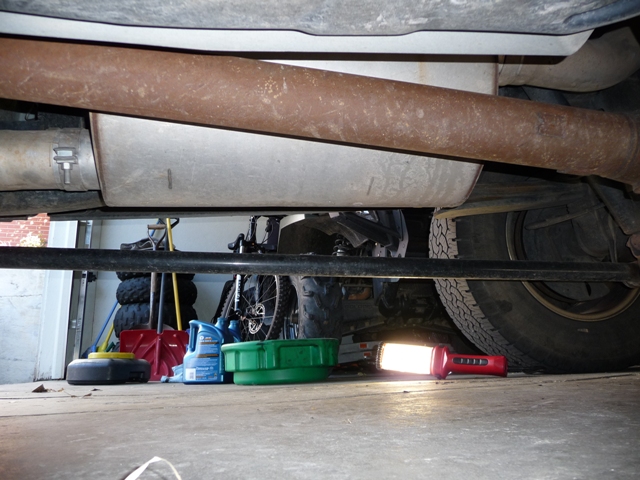

Old Smoky's Avatar
Joined: Jun 2002
Posts: 251
From: Stuck under a hood.
Donaldson M120100 - quite, and a direct replacement. It flows the same as the 51" donaldson that many use, but it fits in the stock location, and is as quiet as stock. My wife hasen't even noticed it's not stock. The tone is just slightly deeper. The inlet and outlet is off set so it fits the stock configuration - just cut the old one out, and slide the new one in. I just cut the hangers off of the stock muff, and welded them to the donaldson. I really dont like the sound of the common rail exhaust, but wanted the performance of a high flow muffler - works great!

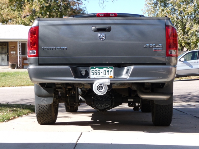

Old Oct 17, 2009 | 03:08 PM
Old Smoky's Avatar
Joined: Jun 2002
Posts: 251
Here are the pics. Hope it works!
Mike
