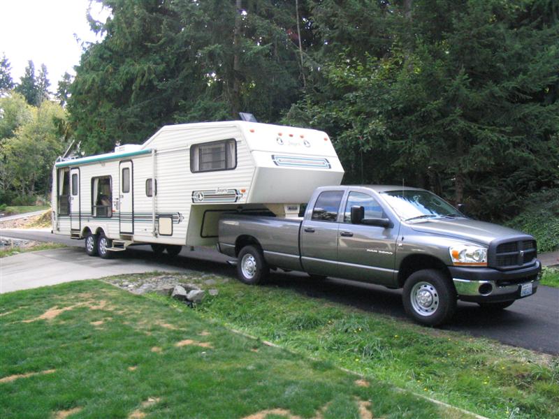

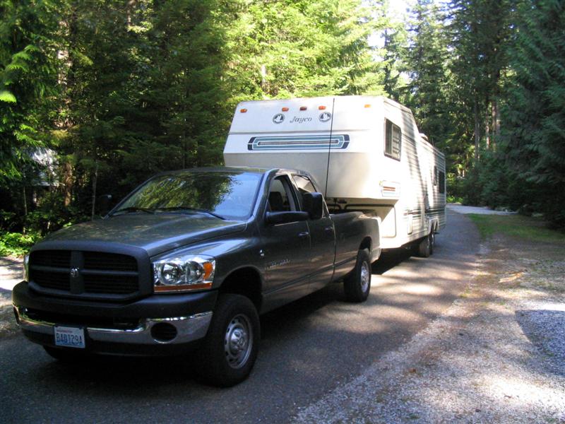

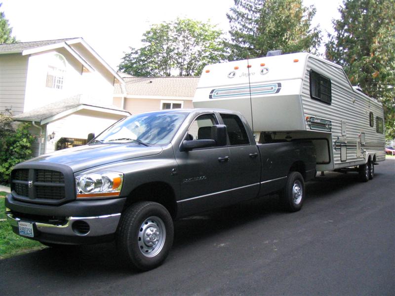

Here's my set up, using the B&W, which I couldn't be happier with. I have it so there is about 8" between tailgate and trailer, could probably be closer but I go on dirt roads.
It's sitting on the hill in front of my house, it really isn't that big of a sag on level ground.
Attached Thumbnails Fifth Wheel Install - Trailer Clearance-rv-33-medium-.jpg   Fifth Wheel Install - Trailer Clearance-rv-36-medium-.jpg   Fifth Wheel Install - Trailer Clearance-truck-53-medium-.jpg
