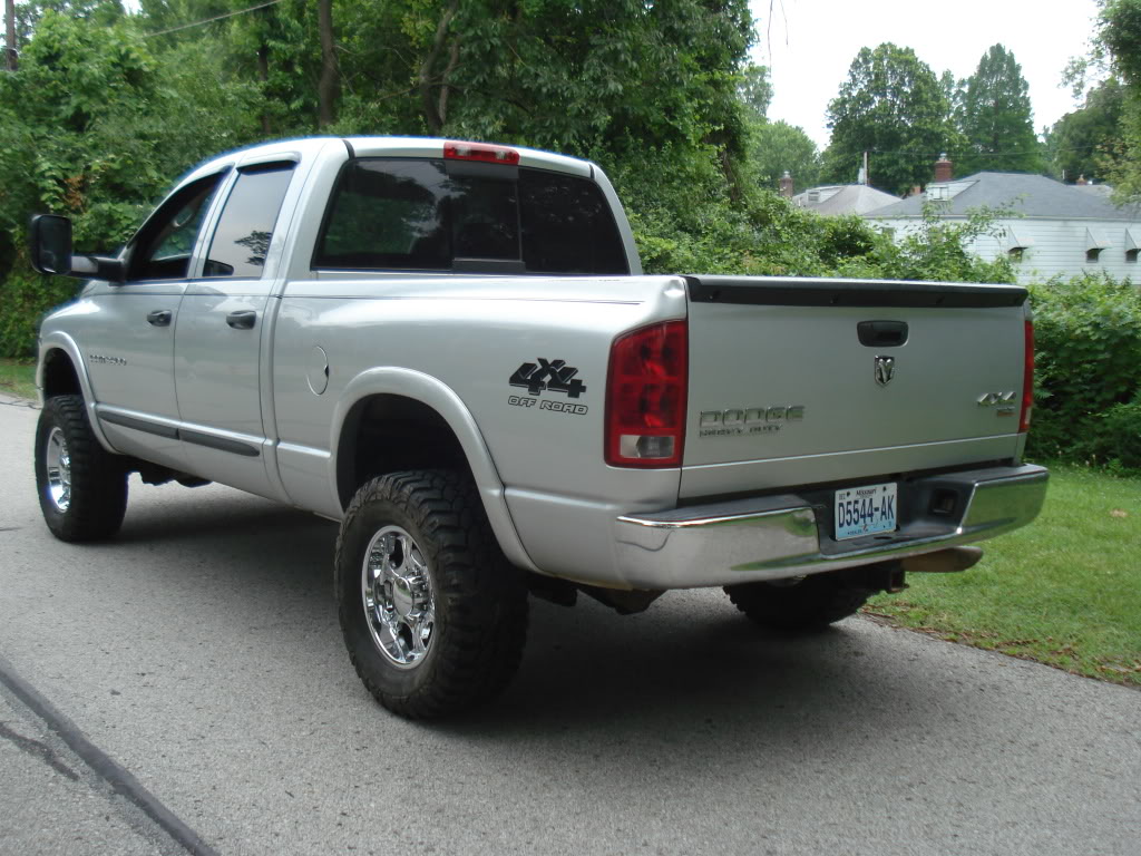

If anyone stumbles across this and would like to trade, I would like to convert mine to a dually. I am out of St. Louis MO. I have an 03 3500 SWB SRW. My number is 314-226-6420 or my email is joe.difranco@yahoo.com I have all the tools and a 10K lift.
