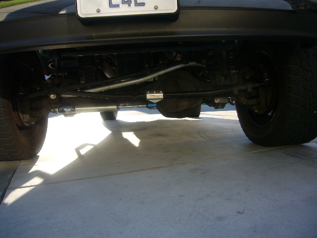

K sorry let meknow if you can see everything in these pics
Attached Thumbnails Cylinder assist steering-p1010851.jpg   Cylinder assist steering-p1010852.jpg   Cylinder assist steering-p1010853.jpg

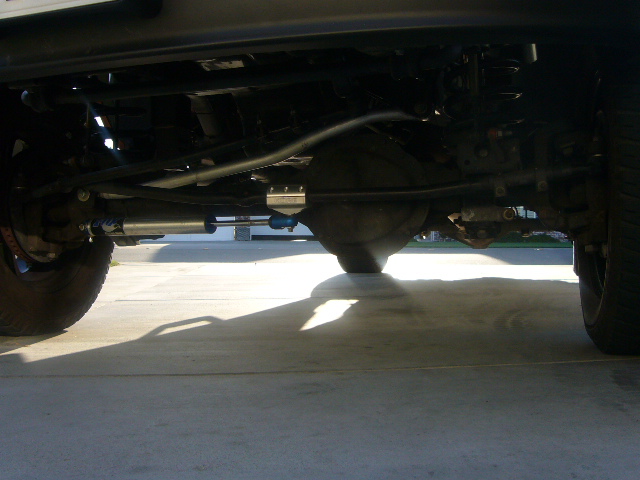

2 more of the front end
Attached Thumbnails Cylinder assist steering-p1010854.jpg   Cylinder assist steering-p1010855.jpg

yeah, those help. the pics are a little dark, but it doesnt appear that the angles are so far out of alignement that it would cause bumpsteer. Do you have an angle finder? if so, run a piece of string between center of bolts for the track and drag, and measure the angles. You havent altered your lengths much if at all, so if anything its got to be the angle. if its not that, I would think one of the track bar bolts is loose or bushings is shot. it really shouldnt be the gear box, unless its a fualty unit.
what size tire are you running? I hate to ask, but are you sure its bump steer?

The angles are off ever so slightly, but I don't think its enough to cause bumpsteer. I'd say your problem lies elsewhere. I don't like drop pitman arms and drop brackets for track bars, but your track bar drop bracket appears to be solid enough. I still think you should start with a sector shaft support of some kind, then re-evaluate. It's a good part to have even if you don't have a problem, so don't feel you wasted money if it doesn't solve all your problems.

but in the end it all about flat parallel steering links..but yours don't look way off so who knows
