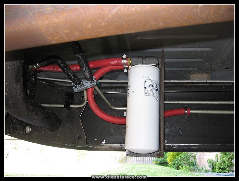

I work for a large corporation that manufacturers diesel fuel filters for many of the major truck/marine diesel engine plants. Diesel fuel by nature is dirty, plain and simple. It requires improved (finer) filtration as the engines continue to produce more power and fewer emissions every year.
Water is the major problem, eventually even the best filters cannot prevent all the water from entering the close tolerance, high pressure fuel components. Water causes corrosion and accelerated wear immediately to the precision components. Additives and asphaltenes in the fuel can "blind" the fuel filter media (paper) and allow water to pass straight through the filter.
Anyway, as an engineer I spent five years working with GM/DMAX with injector wear problems. I saw brand new truck filters returned with less than 1000 miles and the engine had severe fuel system damage due to a large concentration of water. When you see the water in fuel light come on, shut her down and drain the filter and start working towards the tank if alot of water is present. Especially if you just filled up! You may have a pint/quart or even a gallon of water in the fuel tank!
If you end up at a dealer with fuel system problems a good dealer will take a fuel sample from the tank. Next they will check the fuel filter change intervals. This is where having only a dealer change it can save your but because it is recorded and they only use an OEM approved filter. Try to skimp on filter changes and it may cost you. If there is a high concentration of contamination you are on your own.
Loads of water come from the following:
Poor maintenance at the fuel stations (filters not changed on the pumps)
A load of bad fuel.
Fueling after a large storm (water seeps into under ground tanks).
An old tip- Never fuel up if the tanker truck is at the station, as they fill the tanks they stir up all the crap!!!
As with any vehicle every thing is a compromise, the OEM's want one little fuel filter to filter out everything, fit in your hand and only cost $20.00.
The larger the filter (more area) and having a primary and secondary filter is the only way to protect the modern high pressure injection sytems.
