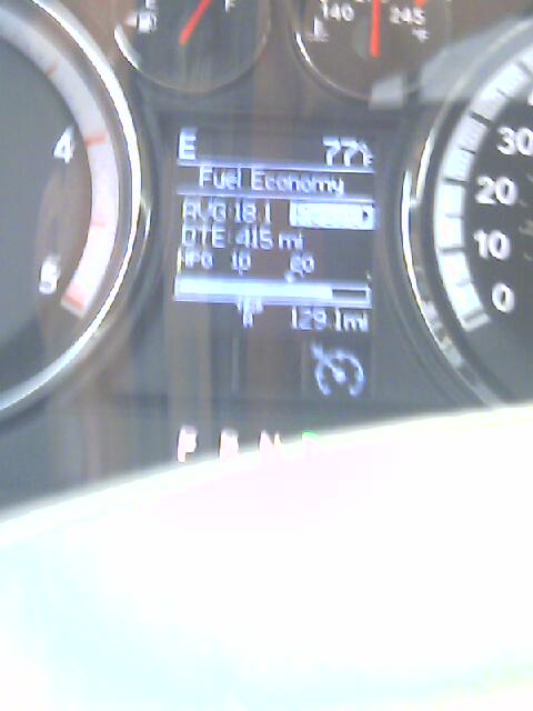

If you want to knwo a go dreason to delete the DPF and program in SMarty see the pic below. This is combined hwy city driving, mostly hwy, in very windy conditions.
Attached Thumbnails what can i do to get better milage on a 2010 ram-cid__moto_0225.jpg
