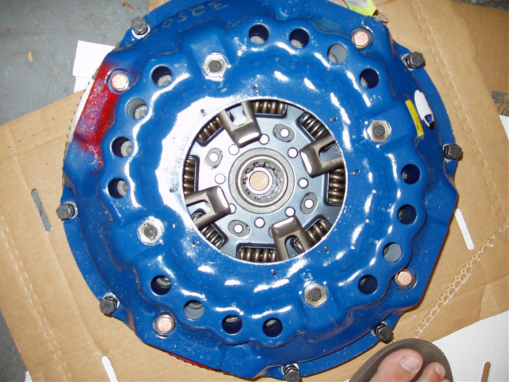

JM, is your PP the 4 finger or diaphram style?
I have ran both and I like the 4 finger better. After goin from a 3250 ceramic diaphram to a 3600 4 finger I could tell little to no diff in the pedal pressure.

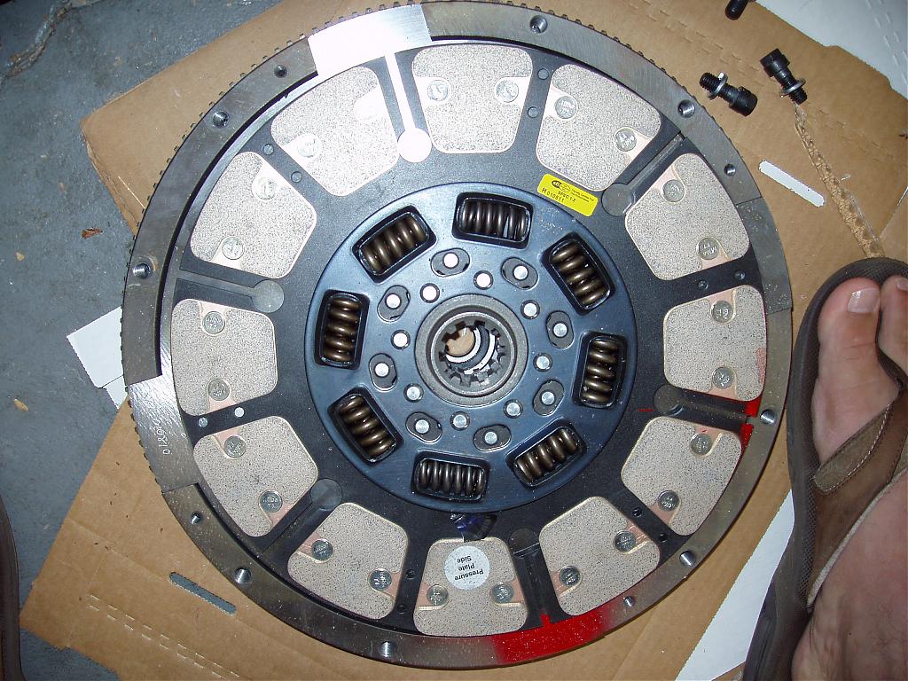

OK, it looks ceramic. What do you all think?

Thanx, just looked at it. Is that ceramic or organic? It looks exactly like mine. Keep me innformed on how you are liking it.
