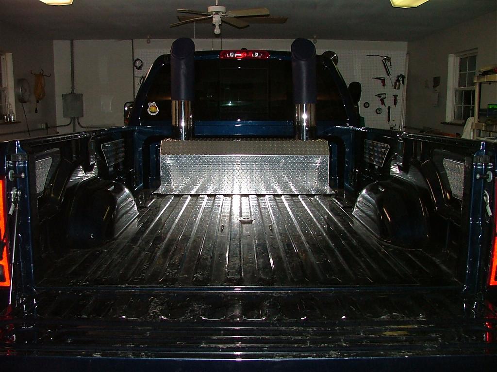

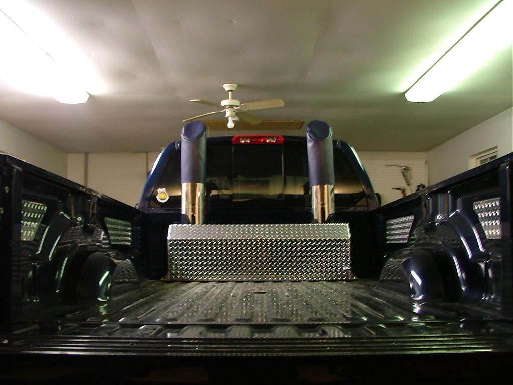

If it's just a drizzle I don't worry about it but, if it's expected to pour down I throw these on. (prototype)
Attached Thumbnails Water-in-Stacks Fix (Info)...-dscf4101.jpg   Water-in-Stacks Fix (Info)...-dscf4108.jpg
Old Feb 17, 2007 | 08:42 PM
bry@n's Avatar
Posts: 234
From: Ocean County, NJ
Prototype? Looks like stack condums.
